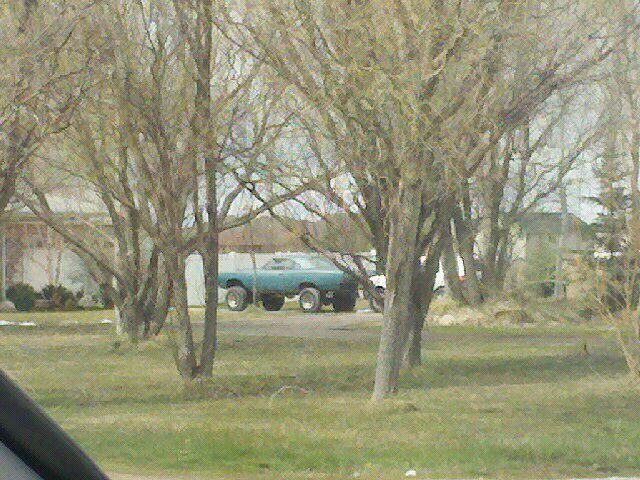

Look what I found on my way to the blasters this weekend. This was about as close as I could get with out going onto the guys property.

I know. I badly want steal it and make it right. I wonder what mods had to be done to that unibody to make that kind of lift. I know it's a 1970 but other than that can't tell.

Don't get me wrong I'm not scolding anyone or saying that this guy should be hung for what he did to that car. I actually thought it was awesome when I saw it because I've never seen one before except for a micromachine I had when I was a kid.
Matt, maybe someday I'll see him outside and talk to him about it...hopefully be able to find out how he did it and get some pics.

Regarding how the guy did the 4X4 conversion on the subject car, it is not that hard. You just find a chassis that will fit wheel base wise for the body you want to use. If you can't find one you just shoten of lengthen the frame. Truck equipment companies do it all the time for flatbeds, service bodies etc. The trickiest then is making the steering column work because of the different angle from the stock car to the 4X4 chassis, but there are ready made product to over come this problem.

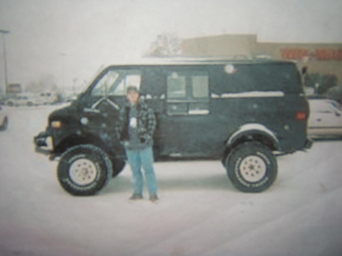

Hmmm.... anyone know the wheelbase of a Ramcharger or a 70's-80's truck by chance?
ramchargers are 106"......reg cab shortbox's are 115". I built a 4x4 '77 dodge tradesman fullsize van a few years back. I tried to set the van sub-frame on a ramcharger frame....wouldn't work. Had to flip the axles, build custom mounts for the front diff, add the t-case, and fab it all together. Worked out pretty good. Cam'd 360, 35" mudders, and a 14000lb winch out front. Sorry for the huge pic...I still haven't figured out how to re-size them
