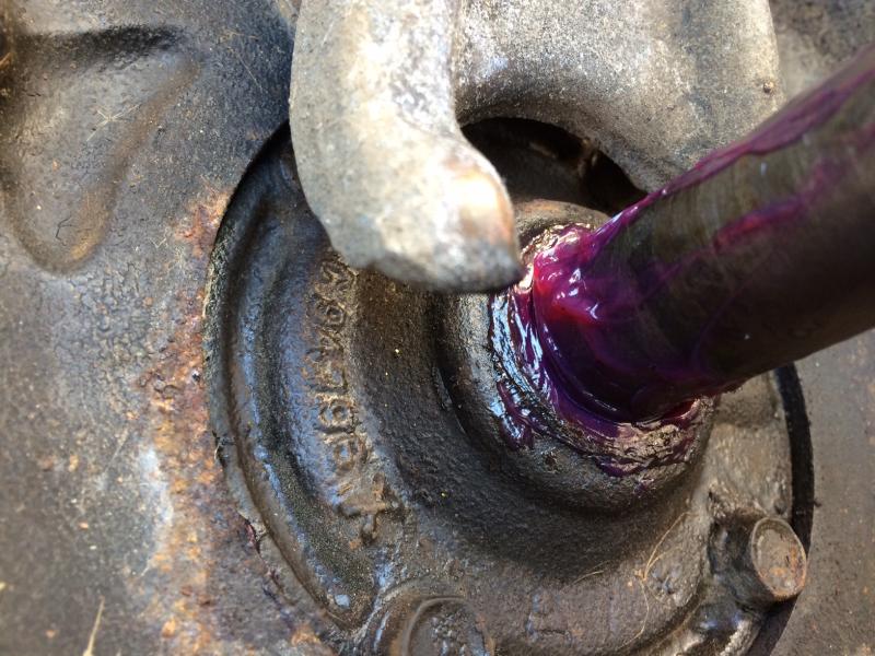

OK - so I took another look at it:
It doesn't have a raised pad for the VIN, so it's pre-68
It has a slip yoke (the one that came with the driveshaft from the '67 440 Imperial 727 A/T fits like a glove
It has the long tail shaft with shifter pad close to case, so it's a B Body.
I am attaching a photo of the bearing retainer since I cannot differentiate one from the other.
But I'm guessing it's a 1965-66 since there is a 3X14X65 stamped on on the driver's side of the case on a raised pad.
It's the smaller bearing (307) trans which is 1969 and back.
