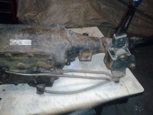

here is a picture of the trans
Not an expert here, but it looks like it has a short tailshaft. Might be from an A-body ?
Thats an a/f body. most likely a duster or dart sport, has to be 3b3 which is 1973 hamtramck then car vin makes it match 4219 date
I also agree with 70bigblockdodge. And on a side note, that 3b3 makes much more sense than the 8b3 did with that 4219 date code. Glad to get this sorted out.
