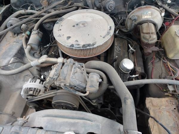

Question about a 74 dart. (not a B body I know) I think they were A bodies? Anyway I am not a member of FABO so I am asking if anyone here would know what engine would have been stock for a 74 Dart? Seen one for sale and it has what appears to be original V8. Car is in great shape and priced modestly. Don't know a thing about them. But this one seems to be highly optioned.
Could've been anywhere from a slant 6 to I think they put a hemi in a few of them, you need to run the VIN and fender tag

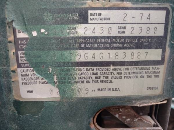

Here is all that is visible.
Could be the original motor but you'd need to check the numbers on the block as well to verify

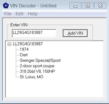

The "G" would indicate a Factory 318 CI - 2BBL. A step up from the /6...
