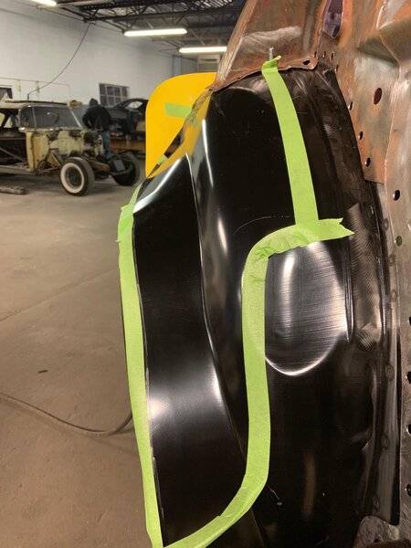

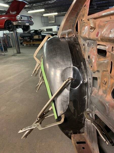

Nascar:
My car:

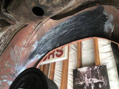

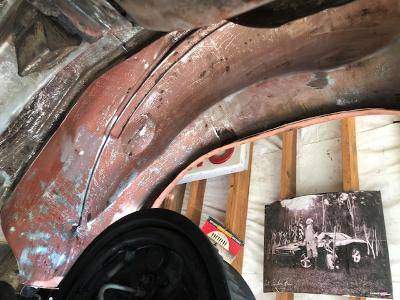

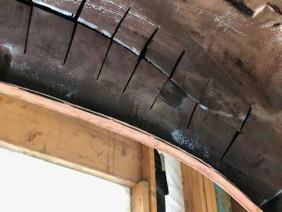

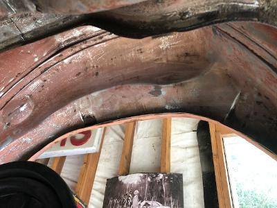

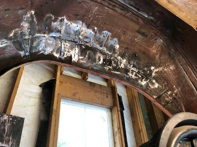

I have the dreaded wheel tub problem in this car and plan to address it.

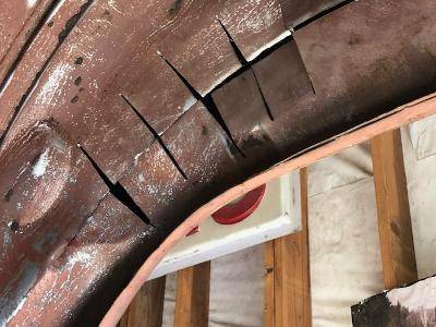

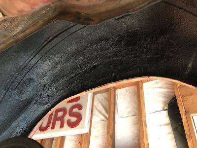

I did a practice run on my other car.
Same model, 1970 Charger. I simply made cuts that sort of resemble football stitching:
Tire clearance greatly improved for almost NO cost aside from welding supplies.
Do you have a welder?
Yep, love the metal and fab work. Hate the finish work.
