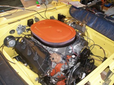

Lowhound: My "383CI" 70 Bee came w/ AC. The guy I bought it from dumped everything under the hood. I put a 70 Hemi in (build date May 69) and I installed the AC unit from Bouchillion Performance.
Bouchillion is MOPAR ONLY
Notice the AC compressor, pulleys and belt in PIC.
I think the price is $400 with everything. Call them to find out.
Bouchillion Performance: www.bpeusa.com OR 843-744-6559
Hope this helps.
