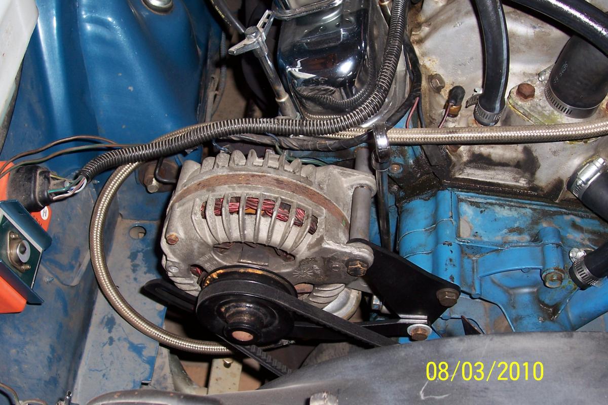

I think I can help you out. I did the same thing on my 318 and have some #'s for you. NAPA belt # 15435 for the alt and if you need, belt # 15455 for wp & ps. The alt belt will travel below the wp shaft and ride in the outside groove of a double groove alt pulley. You will think that it will not work/fit, but it does. I am running it right now. I also purchased a alt bracket kit from Mancini Racing and it works great together. I had trouble coming up with a factory style pulley as well and the $ thing was a factor too. If you need the Mancini part #, let me know and I will locate my receipt. I think it was around $30-40 w/ shipping- it would be a non ac kit complete with brackets, bolts, spacers & instructions. Black in color or you can get chrome (at least 200hp gain- ha ha). good luck!
I found a pic I took awhile back. Hope it helps. Don't mind the dirt, she just woke up from a 7 year nap. I can't take the credit with coming up with this config, a fellow club member helped me out as he did the same thing.
