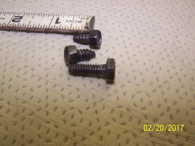

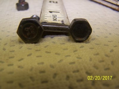

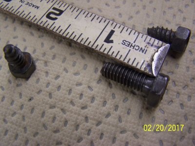

I'm looking for a picture of the screws (or bolts) that hold the drier bracket to the RH inner fender. Also need a picture of the screw (or bolt) that clamps the drier onto the mounting bracket.

Here ya go Richard. The clamp bolt is a 1/4-20 X 3/4". The mounting screws are a coarse thread 1/4" X just under 1/2" long.
Here are some pics of the bolts on my 68 Charger.
Thank you sir! Are those 3/8" or 7/16" hex heads on the shorty bolts?
