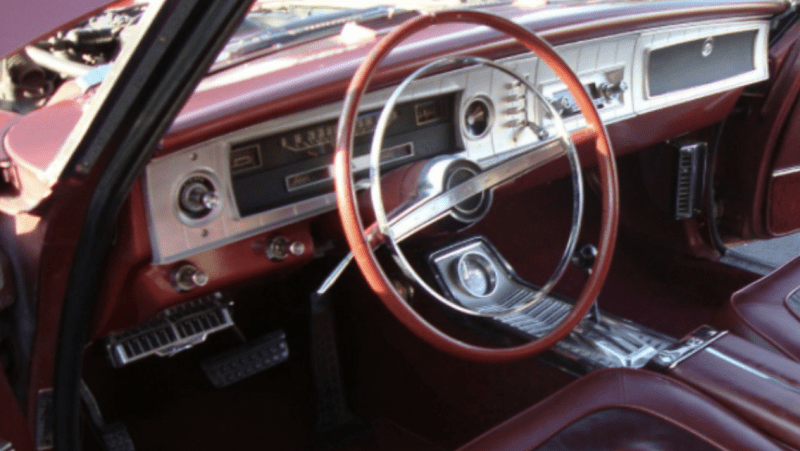

I have just purchased a 1965 Plymouth Satellite with a big block (converted from poly). Originally it was an A/C car but that is long gone. My question is this: Does anyone have a clear picture of the dash of an A/C 1965 Belvedere or Satellite? The only "vents" I see are beside the speaker on top of the dash. I would certainly think there must have been more. Also, does anyone have the various brackets to put A/C back - it is far to hot here in TN to not have some air movement (like non-A/C cars have).

Dodge, but same thing
Maybe it had a dealer installed AC unit originally?? They were very common....just a console hanging under the center of dash.

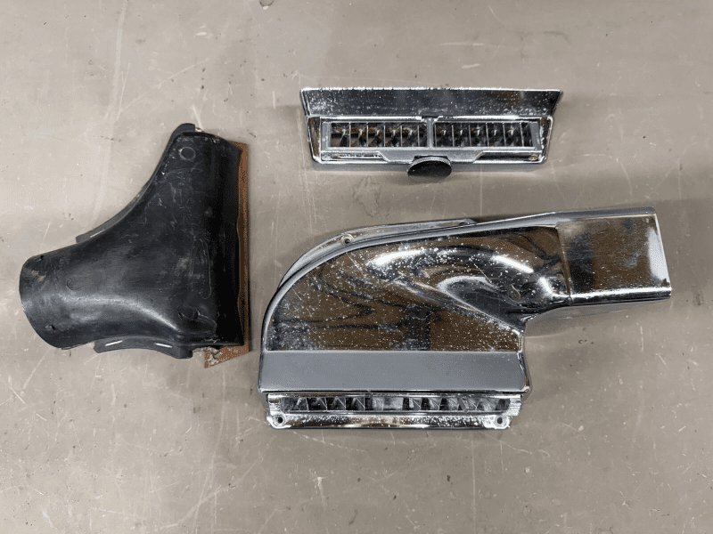

Thanks for the information. I have the build sheet and it is a factory air car. someone must have removed the two vent outlets under the driver's dash and passenger's kick panel. That picture is quite helpful, which I had a few more. Thanks Jeff.

P.S. where can I locate the remaining vents?
I ha seen the factory vents pop up on eBay from time to time. I used a universal kit
Thanks for the ebay tip. $495 really isn't too bad I guess.

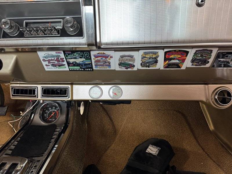

Hey Scott, do you have any pictures of your vintage air install, both under hood and in the cabin? Sure would appreciate seeing your installation results. It's going to be 94 today with a heat index of 101... I need to get that thing air conditioned.

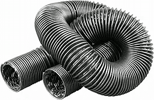

I don't see why not, when I put the "Old Air Products" system in our ramp truck I hooked the hoses for the factory defrost vents up to the new system, it didn't have air before, so no factory dash vent.
I think 2" is pretty standard for hose size but, they make reducers/adapters.

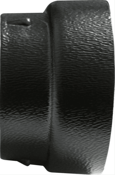

This a 2.5 to 3,
you just need to figure out what the vent inlet size and plenum outlet size is and buy accordingly.
nice looking install Scott. How about the controls? Did you use the factory dash control cluster.

I used the original temp selector and fan knob. I mounted the heat, vent, defrost selector in the ashtray.
not unless I take it apart, maybe when I put the cruise control in I can get some pics
