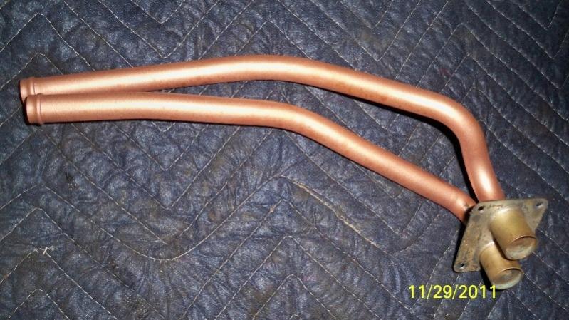

Does anyone know if the ac cars have the same core but just have extensions to get them through the firewall? I seen a resto thread that shows the extension that fits on the heater core with O-rings.
The A/C core is totally different. If you want I can snap a picture of an A/C and non-A/C core for comparison in the next day or two.
