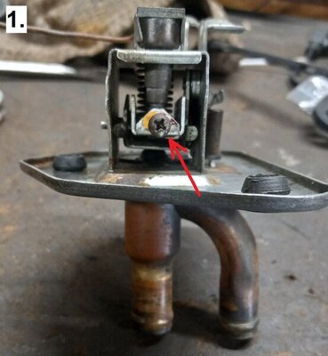

I'm installing my A/C water valve to the firewall (1968 B Body). I need re-connect the capillary tube to the back of the water valve.
Questions:

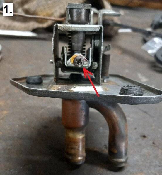

Pic 1. What is this screw (red arrow) used for?

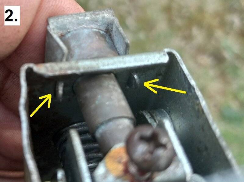

Pic 2. Do I bend these tabs (yellow arrows) over to secure the tube housing? If so, outwards or inwards?

You replaced the seal with the NAPA kit? The small screw sets the tiny bit of travel for the capillary system. The tabs are delicate, they bend outwards. If they don't break that is.

As for the screw, do you set it and if so what are the adjustments to look for? Because once the AC box is in place there's no getting to that screw easily.
