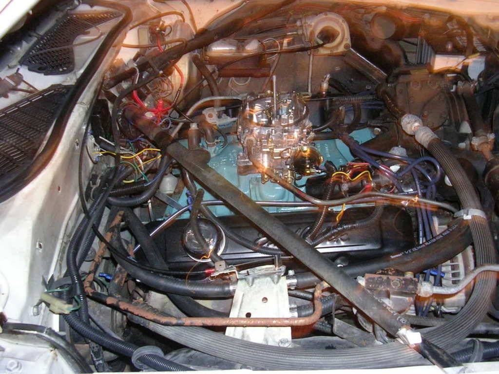

:angryfire: I HAVE THE SAME ISSUE ONLY SOME MORON TOOK OUT THE TWO VALVE STEMS FOR SOME REASON AND HAD SOME CABLE HOLDER THAT LOOKS LIKE A T AND THE TOP AND BOTTOM OF THE T HAD THE HEATER HOSES BETWEEN THEM AND THE SOME TYPE OF CABLE HOLDER THAT WAS ATTACHED TO THE INNER HEATER HOSE APPROX 6'' OUT AND THEM CONNECTED THEM UP AGAIN..THE CABLE WAS ONLY IN PLACE BETWEEN THE HOSES SO I AM NOT SURE HOW WELL IT WORKED IF AT ALL WHEN IT WAS SO LOSE.
I JUST BOUGHT THE DOUBLE STEM OF THE FIREWALL THAT LOOKS LIKE AN UPSIDE DOWN TRIANGLE OUT OF A 69 CORONET TO TRY TO FIX..I HAVE NO IDEA WHY SOMEONE WOULD REMOVE IT..THE OTHER A/C PARTS ARE FINE..WTF ..WHY WOULD SOMEONE TO DO THIS ..WHAT IS THE PURPOSE. I AM GOING TO UPLOAD A PHOTO TOMORROW DURING THE DAY ,SO YOU CAN SEE WHAT THIS MORON DID...DOES ANY ONE KNOW WHAT ISSUES I MAY HAVE REATTACHING THE PART BACK TO THE FIREWALL??.. WHAT IS THE PART CALLED > ? THANKS RICK

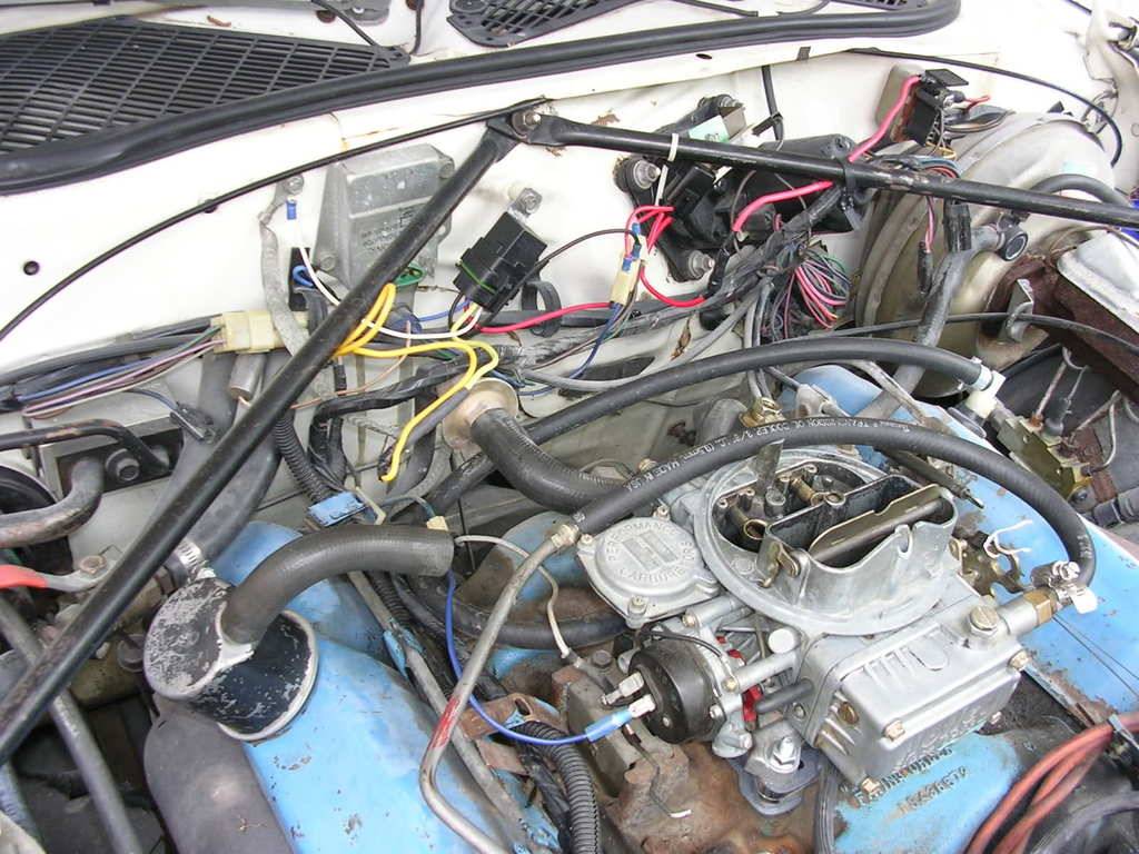

BTW - That fuel line looks a little questionable.
Yeah, it was. That set up was just to get the engine running to set timing. I stripped out all the Lean Burn equipment and put in a Pertronix distributor. I threw that old Holley on because the T'quad was no good and set up for LB system.
