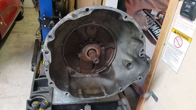

Some quick details:
73 Road Runner, 340 and 727, 3.55 rear. Car was a regular driver, and no issues with the transmission. Almost 4 years ago the 340 threw a rod out the block and I am now just putting the car back together. I have very limited time, but want to try to ensure the 727 works well.
Question #1:
There is evidence of a leak out the front of the transmission. Is this seal something fairly straight forward to replace (I have never rebuilt a transmission before)? Any advice here would be appreciated.
Question #2:
The transmission has been indoors, drained of fluid, in my room temperature basement for 4 years. Can I simply fill with fresh fluid and put it back in? What is the likelihood of stuff slicking/ not working well? Any recommendations?
Thanks in advance for any advice and assistance. I know that the ideal thing would be to go through the transmission and refresh/ rebuild it, but I doubt I have time to learn how to do it in just a few days.

First, thank you for all the great replies. Here is an update on the transmission:
I pulled the pan and visually checked things out. The pan was super clean, with no particles of any kind, but with a little bit of greyish material that showed up on the rag when I wiped the pan out. I believe this is totally normal, so the transmission will get a new filter and pan gasket and it will run again!
All other transmissions I have seen have a thin metal plate over the vent that sits at the top of the pump housing. Mine did not (you can see it is missing on the first post). I removed one from another transmission I had laying around and bolted that on. Maybe that could contribute to some seepage?
Due to limited time, I decided not to replace the seals at this time. I know in an ideal world I should, but this tranny really didn't have any issues to speak of 4 years ago, and I have some other problems with my engine installation that I need to devote time to. I installed it on the engine (after lubricating the front seal and partially filling the torque converter).

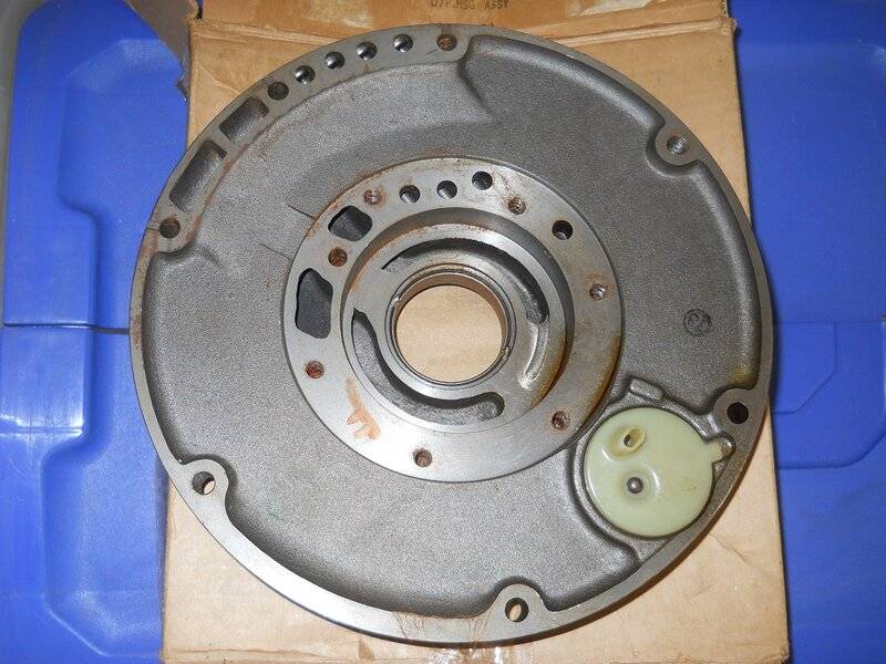

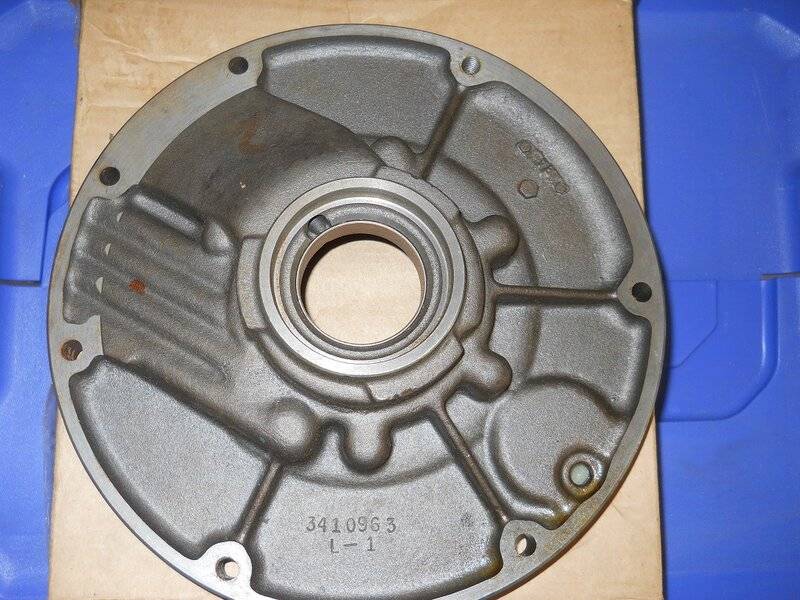

They changed the vent to a plastic piece and the plate won’t go on anymore. So if he was able to install one on his pump then it should be there.
Here is the newer pump with th plastic vent, you can see the round shape from the front so you can tell on an assembled trans.
44F67455-0AA8-4E0A-8024-49AF36958ED2.jpeg 526F00C1-DCEC-4515-BA6A-07EFCEE0A0D9.jpeg
View attachment 1150926 View attachment 1150927
Thanks. My transmission definitely did not have the plastic vent. I don't know if a transmission without the metal plate over the hole would seep slightly, but I'd rather have it on there. The engineers put it there for a reason!
It’s just so dirt won’t get inside, makes it go around corners with the plate. it won’t keep anything inside from coming out if it wants out
