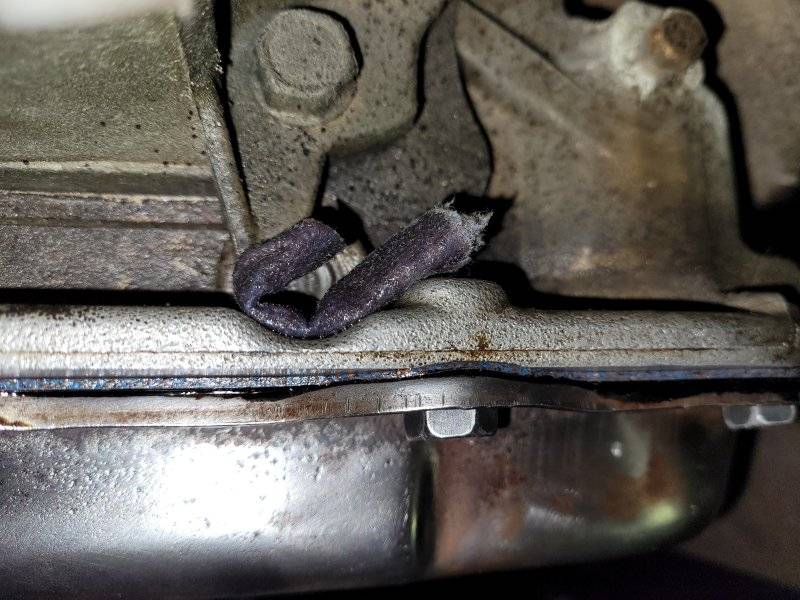

DVW just uses RTV!
I happened to have the fuel tank sealer handy.. it's $300 a quart or so now. I drained the fluid down by putting an aquarium tube down the tip stick tube and letting it syphon and lifted the *** end of the car so the pin would stop weeping..

Shift selector seal, it's always the shift selector seal...
