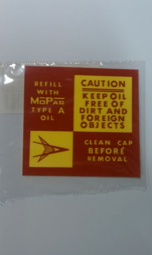

Does anybody know where exactly this decal is meant to go on a TRW PS pump? - (I thought on the filler neck, but decal is too tall)

Any idea about the PS pump decal position?

I have the same problem. I have seen them on the tank to the right of fill.(looking to the rear of car.) So far I have left mine off.
Thanks for the reply. I have scoured the net looking for a clue and so far zilch....
