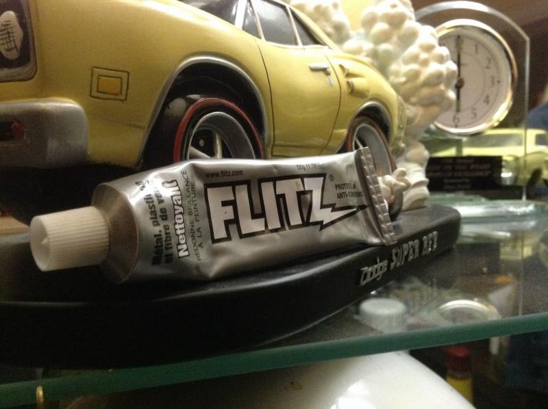

Sounds like you are describing my car. No one I know has a B Body with a fuel gauge that works. When I do some dash work and wiring the lenses will be cleaned up with this. image.jpg I have used this with good results on plastic for clarity.
