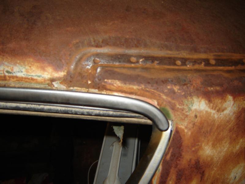

Okay... I decided to brave the swampy conditions and snap some pics.

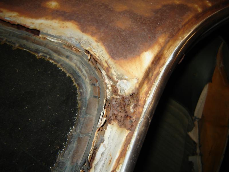

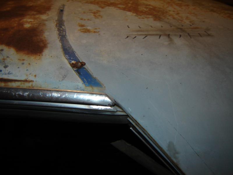

I'm gonna upload them in stages so they don't cram together on one post. Here is the corner of the roof at the qtr. window, 1st is the Charger, 2nd is the RR, both are '71s. The "step" in the roof panel appears to be specifically designed to account for different qtr. window shapes.
Edit: Arrrgh...
My two posts crammed togther..
Ok.. 1st two pics

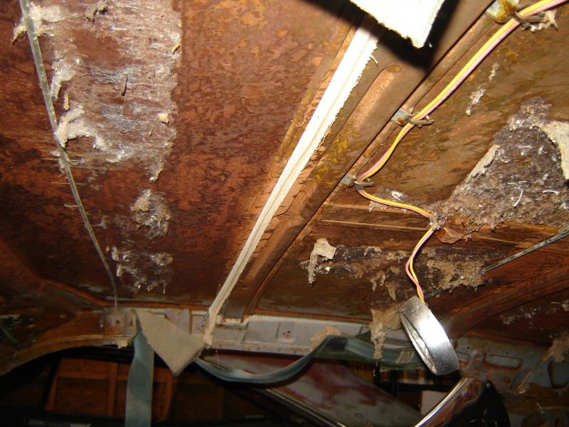

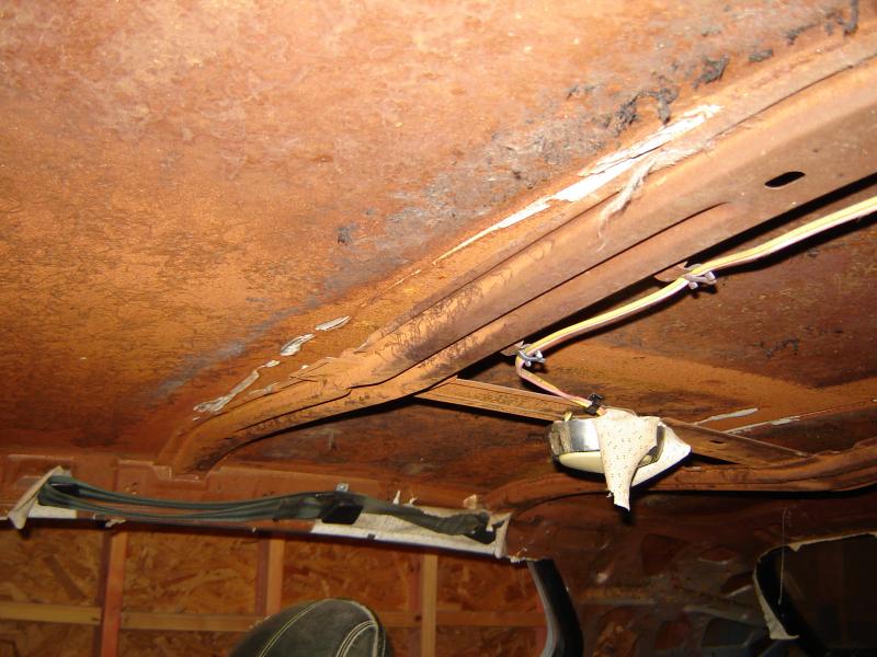

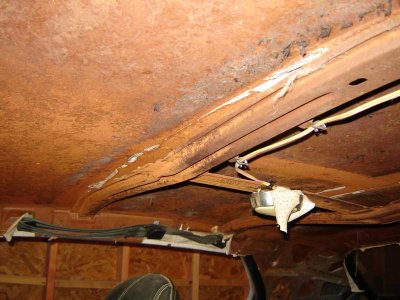

Under skin bracing appears to be identical. Note the damage to my RR, looks like somebody tossed something heavy on the roof and dented the whole thing in... then "popped" the skin back up. This is the reason I want to salvage the bracing from the Charger.

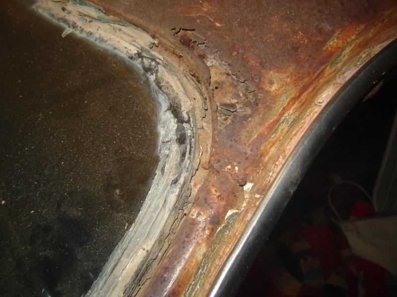

Last 2 pics, A-pillar joints. Charger is 1st, RR is second.

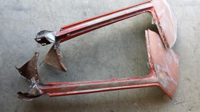

A-pillars are the same for 71-4B 2-door as are the roof Skins. The drip rails are different between years and models. The drip rails on the A-pillars are screwed/glued on and the rails on the roof are welded on.

I believe the "steps" referred to in post #14 are on the quarter panel and not on the roof skin.
