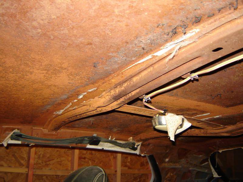

You are 100% correct YY1. My new AMD quarters have the steps and so did the original metal that I cut out.
This thread has a good question. I have been curious about the differences since I started on my 71 RR. Thank you everyone for helping out.
I think there may be a small step on the roof skin too. I'll try to take notice next time I go out to the shop.
I'm not trying to high jack your thread Chase. Just very curious about it. I've learned a lot on this thread. Thanks again.
In the top picture of post #14 you can see the small step on the roof panel too. I remember on my car the quarter went under the roof metal skin. The step down area allows for the body filler in the seam so there are no high spots to contend with on the lead seam.
