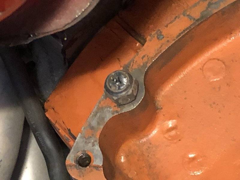

I'm hoping someone might be able to help me out here. This isn't a B-Body specific issue, but it IS Mopar related. I am trying to drop the front driveshaft on my 2000 Dakota 4X4 to change out the U-joint, but have run into a giant snag. I'm posting here because I suspect I'll get more help than on the Dakota specific forum.
I got all four of the front bolts off, as well as 3 of the 4 bolts at the transfer case, but stripped the living hell out of the last one...of course. It's one of the longer bolts at the transfer case end.
Is there any way to get the driveshaft off without having to get that one last bolt out? I even tried the hammer and chisel deal, but only managed to further mangle the still stuck bolt.
Any ideas or hints would be greatly appreciated.

Got a welder? Weld a nut onto your bolt... Now you have a place for the wrench to grab.... And your added heat to help break it free...
It doesn't have to just be a threaded bolt either.

Sounds like you're talking about the velocity joint at the transfer case. If you're just replacing the U joint at the axle can't you just slide the shaft apart and leave the transfer case end bolted up? Put the other three bolts back in.

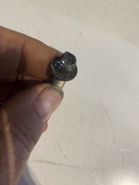

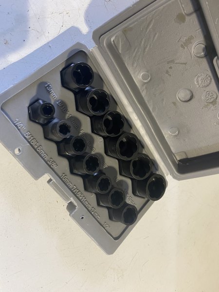

Well, in the end, I managed to solve the issue without having to weld onto anything. That would have been a challenge, as I have neither a welder, nor a friend who has one. A bit of Internet sleuthing revealed a socket-type set that acts exactly like those "easy-out" things, but for bolts rather than screws. I had my doubts, but it worked like a charm. I'm pretty sure this is going to be a valuable part of my mediocre tool collection.
I picked up a set from my local Canadian Tire store - I'm sure you guys south of the border have an equivalent. Amazon sells them too, but I didn't want to wait for the set to show up...and CHINA. 'Nuff said.
Here are a couple of crappy pictures showing the stripped, chiseled, and thoroughly mangled bolt that came right out...and the bolt removal set.

A set of those strip sockets can be your best friend...I use them all the time on rusty junk
