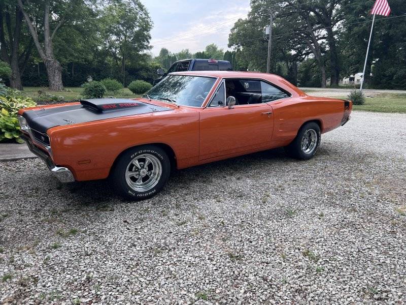

How’s it going everyone? Like many of you I spent my younger years in and out of various dodges and plymouths, always with a strong affection for B bodies in particular. Took a 20+ year hiatus between the last one I sold and my most recent acquisition this summer. My son has been bitten by the bug as well so we are embarking on this journey together. Wanted a running driving project and not a full resto candidate so we can work on it here and there, but still enjoy driving it. We found a 1969 Coronet 440 hardtop, originally a 318 car with factory air. It had started undergoing the “tribute” process by the former owners. I have always loved the ‘69-1/2 A12 aesthetic that’s what hooked me at first & the solid drivetrain including a rowdy sounding 440 six pack was enough to reel me in. Having said that, there is much that still needs to be done. First and foremost is the entire front end needs to be gone through. Quite a bit of play in the steering box, and generally sloppy handling. Being a clone, I have no qualms about updating the suspension with no concerns for originality, though I have no plans of going full restomod, just tasteful stock appearing updates. Anyhow, if anyone has done this type of work on their own car, I’d love to hear from you and welcome your recommendations as there are so many directions to go in this regard.

Welcome to FBBO from Ontario. That looks like a great project Coronet. Your steering / suspension troubles could be lower A arm inner pivots. Lots of people replace ball joints, the rod ends, etc., but never touch those, because it is such a rotten job.

Yes, I am sure those inner pivots should be replaced. Not sure they have ever been touched. In regards to your purchase in 1969… it would have been nice to have a crystal ball right about then.

I would recommend upgrading to the larger tie rod ends, and solid adjuster sleeves when you rebuild the front suspension.
