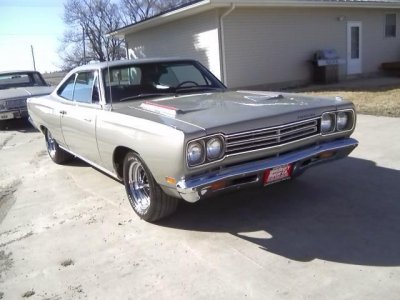

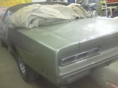

Boy that's a tough call. Spray some test panels and you still won't know until the paint is laid down. There are 2 A4 cars being built in my area and both look different. I don't know what brand each are but one is more green than the other. Both are cool colors though. tmm

It might be the lighting or camera but the dodge looks much greener. Are they real A4 cars? The plymouth looks very nice!
Both are A 4 cars and I have to apologize for the poor cell phone shots. The Coronet was a surprise. I went to pick up a k member and there it was. It looked more green to me also. Different paint brands will give you different shades of the same color for sure. The Road Runner looked green under florescent lights and silver in the sun. Both cars looked great with Magnum wheels and the Coronet had a black vinyl top. tmm

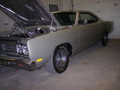

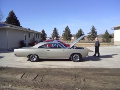

Getting closer to be completed. Just a couple of bugs to work out. I only have cell phone shots but it's a real pretty car. It is so close to the color on my Dart I am thinking pretty serious about using this color. tmm

depends on the mixer as well.
I've had Y1 mixed 4 times at 2 shops and all three different.
One is REAL close, and next time I'm gonna color match that.
