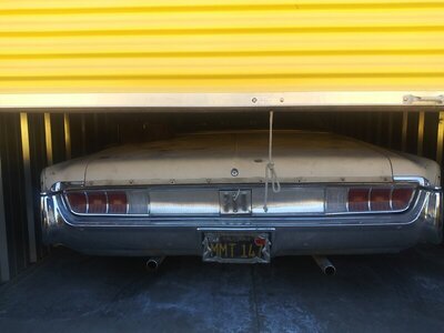

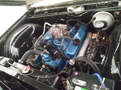

So im visiting my first love in storage today a 65 chrysler 300. I put a new o ring on the shifter cable but i cant seem to adjust it right. This car is far from a show car. It would never shift all the way into 1st gear. I pulled the cable all the way out, with the shifter in 2nd and turned the adjuster wheel back 5 holes using the first hole to line up as one. The car is acting as park is neutral and reverse is forward. Ive tried adjusted 3, 4 and even 6 holes for the hell of it and theres not a lot of difference. What am i missing and how perfect does the adjustment have to be to avoid damage. Any help is appreciated.
