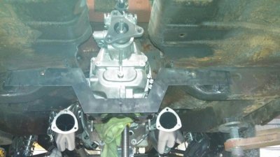

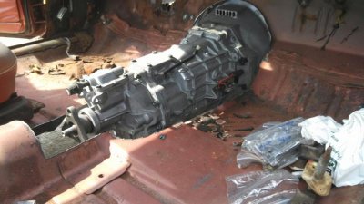

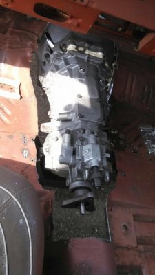

DONT CUT THE HEMI CAR....i would look into the passion...im putting a tremec 6 speed tr6060 in mine. a little cutting involved. i would not do this to a real HEMI car. jmo

WOW ! You call that ALITTLE Cutting ?? I did prostock cars with that mutch tunnle work !
