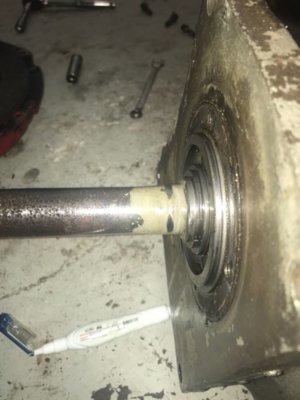

Looks like someone filled the shaft where the seal goes and where the pilot bearing goes.
Pilot bearing looks bent out of shape and has been doused in grease.
Looks like I have to pull the shaft and get in to engineers, no lathe here.
I disagree. In a roller bearing there has to be some play. This is exaggerated at the end of the shaft. If you have this amount of play with the main shaft in place then yes, you have excessive wear BUT if you had already pulled out the main shaft then what you have is pretty normal.
The seal goes in and seals one way. Put it in wrong and it will leak. They possibly installed it wrong and that mess was their fix.
Looks like filler. I’m wondering if the shaft was pitted and worn where the seal sits. Shame to reseat it and it to leak.

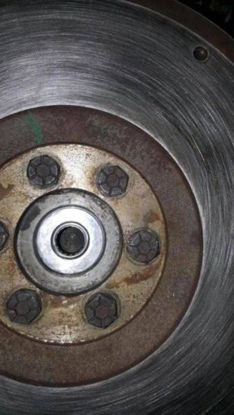

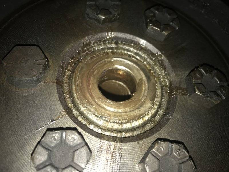

Mine has a bearing the there but it look damaged. It’s been packed with grease but I’d say the shaft was spinning in it when clutched.
I was getting an intermittent noise which I thought was the release bearing but that seems fine.
Here is the bearing

The epoxy repair on the shaft would bother me and I'd replace the input shaft.
Be careful who you take advice from.
My post was in reference to the area that is worn out and epoxy was applied to restore it....which I would not even consider reusing......
Hence not normal....worn out........
Funny, the consensus is to replace the shaft....hmm.....guess the advice was correct.....

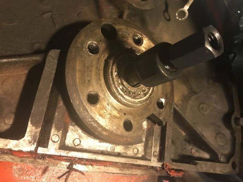

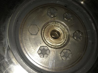

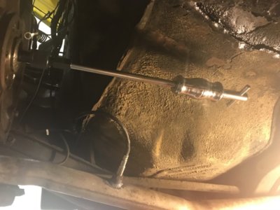

Damn pilot bearing stuck in crack. Even took weight off my larger slide hammer and it’s still no good. Any suggestions before I take an airsaw to it
