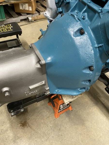

Wow. 20 bits? Must have been good ones?Done deal. I made a call to a friend and he said I would be fine. So, I started with a 3/16 and ended with a 7/8. There is a lot of sizes between those two. I went up one size at a time. I measured the 69 depth and it is 2 1/4" deep by my tape. I drilled my '70 to 2 3/8". This process took me a couple hours but was well worth it. I am very happy that I won't have to cut the input shaft of the transmission.
