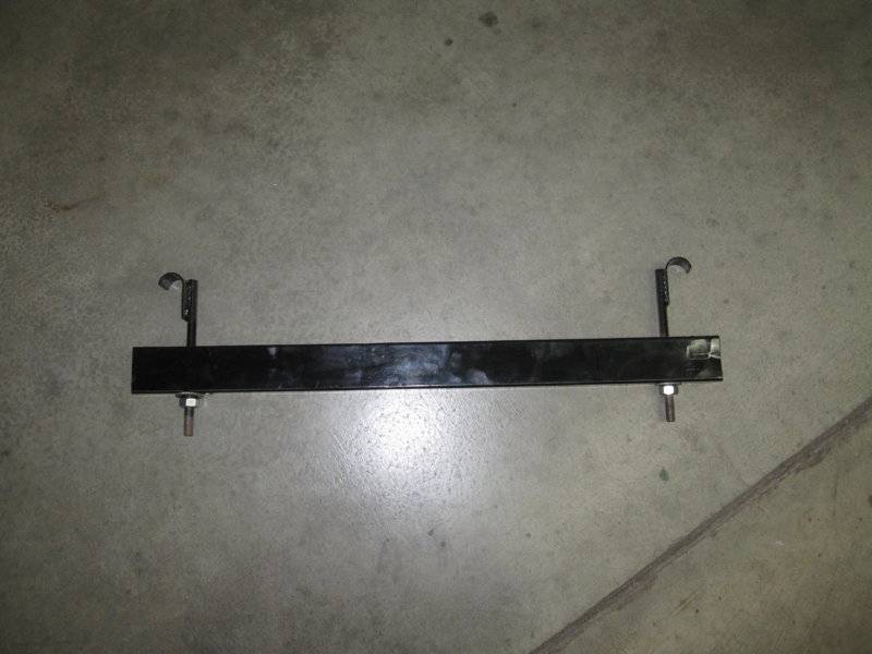

I built this fixture several years ago to hold up and adjust the engine elevation. If you have torsion bars this works slick. I used scrap I had: 1/2" all thread rod, some flat stock, and a piece of rectangular tubing (shipping crate from my Kubota tractor). There is no reason a piece of 2"x 4" lumber wouldn't substitute for the tubing.
Mike
Consider any tilting of the engine on components such as shroud, fan, SB distributor, etc. Ya' don't want to be replacing stuff unnecessarily.

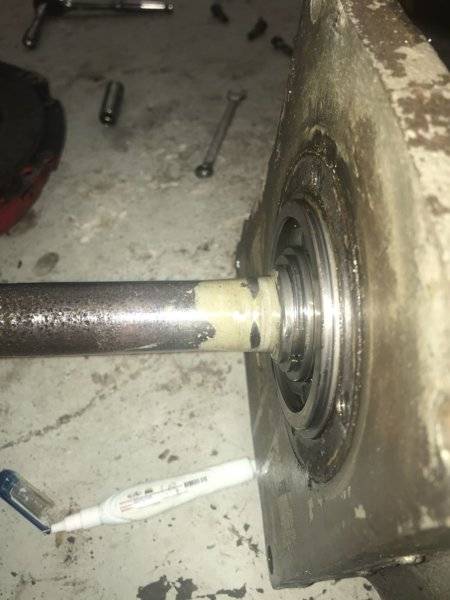

It’s out. Some things are best left alone. That was tough going. Had to get the bellhousing off the get the box back far enough.
Anywho here is what I found. Should there be this much play. Looks like someone filled the shaft where the seal sits too
There should be an oil seal inside the front bearing retainer. Is it there? There also is an oil 'slinger' on the inside of that front bearing. Hopefully that is still in place. The movement is normal for a ball bearing . Once the transmission input shaft is located in the pilot bushing, there is no more movement. BTW, make sure the pilot bushing is in good shape.
