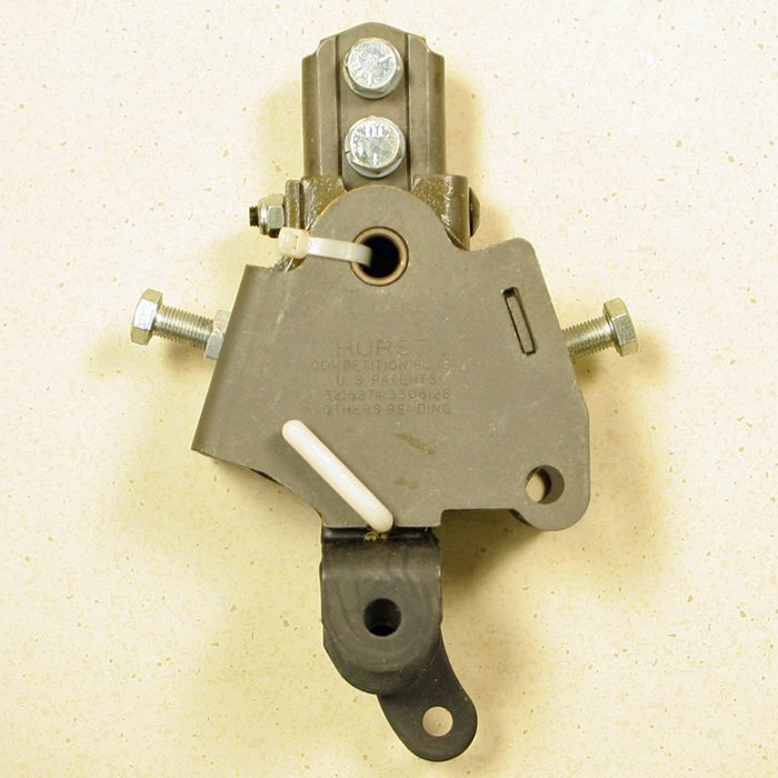

Have you checked the two stop bolts at the Shifter Mechanism?
Popping out of gear can mean internal problems. If it still does it after you check the shifter adjustment then might be time to pull it apart. If the main shaft pilot is severely worn that will cause popping out of gear.
I haven't checked the 2 stop bolts, but I will. I'm assuming internal problems, but I guess wishful thinking on my part that possibly the shifter could cause it. Thanks for the picture and I appreciate the help.
An update. The sloppiness in the shifter was a loose bolt. I fixed that easily and slid underneath to look the tranny over. Hell, it looks almost new! I looked at the shifter stop bolts, and they are not interfering or prematurely stopping the shift in any gear. In fact, on one side it doesn't even contact the shifter mechanism at all. I did make a couple of linkage adjustments, but honestly, they looked okay...maybe not quite centered in the holes, but good enough in my mind. So, I guess it's internal. Thanks again for the help and advice
