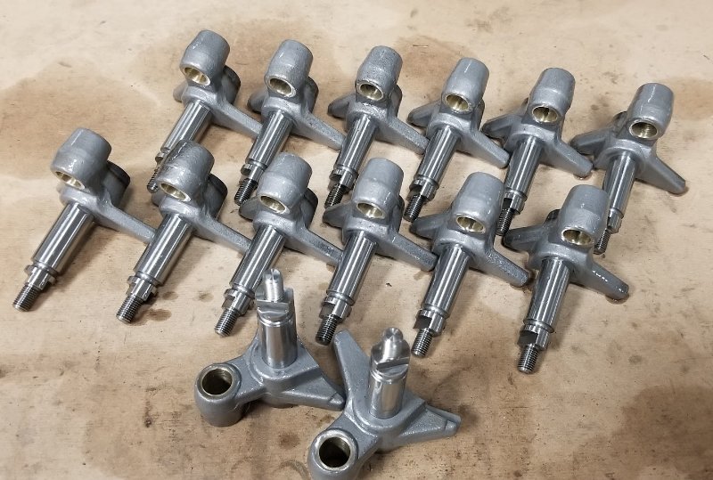

IF you find that the repair doesn't hold, we repair the cam assemblies by replacing the entire shaft. You searched for gl2 - Mopar A833 4-Speed Transmission & Component Specialists
