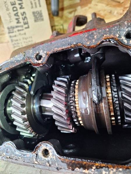

Hi folks. Just pulled the trans out of my 63 Savoy because of 2nd gear trouble. It's supposed to be an A903 trans and it looks like it is but the 2-3 synchro is not what it's supposed to be. The A903 and A745 had a ring and pin type synchro. Mine has a regular brass ring type synchro assembly in it. Does anyone know if the A903 and A745 were upgradable to a newer synchro? Thanks, Wally
