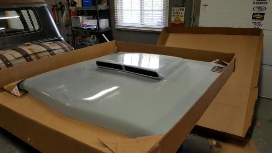

Approximately
13" from the sides
22" from the front
4" from the rear
I had one handy :)

I would think for a 70 you would have to buy just a scoop and mount it on a stock hood?

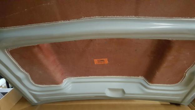

does there appear that the hole can be enlarged from ghe underside without cutting any framework?
Mine is from AAR Fibreglass made by Stinger. I'm not sure if they are all the same underneath
Perfect! I saw an A12 hood online with a rectangular opening underneath which would require trimming. With yours I am good to go.
I owe you my friend!!! Thanks.

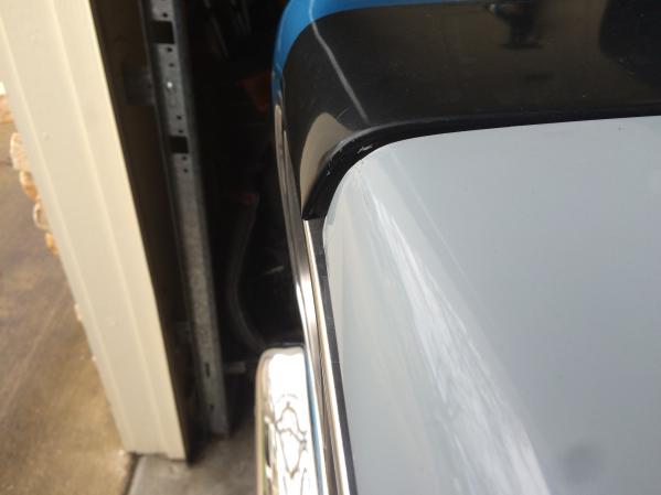

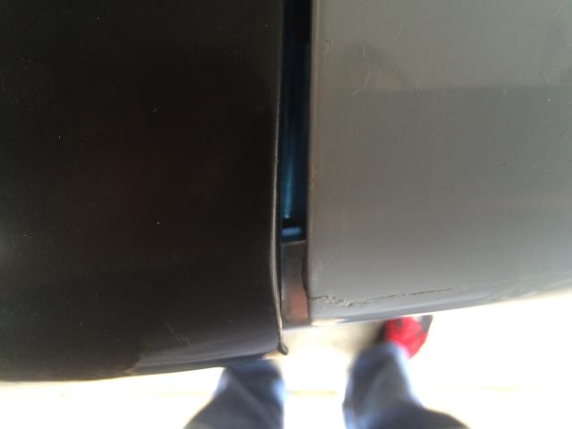

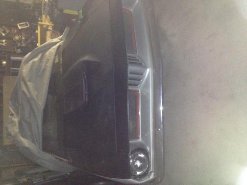

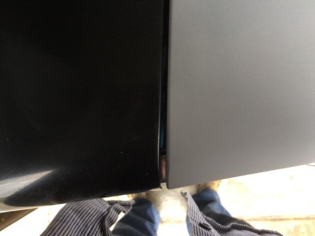

My Hemi dart hood from aar was perfect 7 ago.
My new six bbl road runner hood has great gaps and lined up perfect except for one corner. I fixed it but disappointed.
Tom
