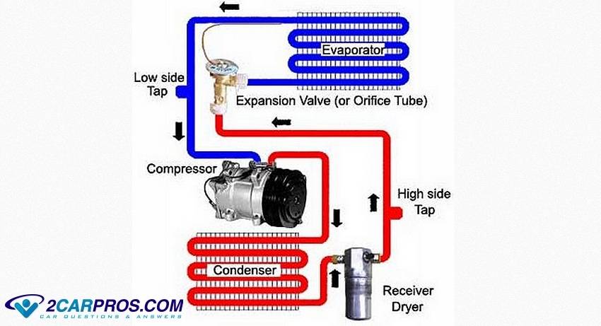

Don't mean to sound like a wise ***, but it tells you what the high side pressure is. Not sure how else to explain it.
Maybe this will help.
http://www.acpartshouse.com/how-an-air-conditioner-works
