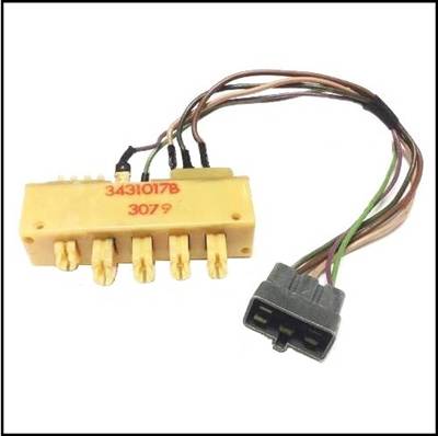

with it out of the car should I be able to push in all the bottons one at a time? Mine only one will go in. 70 charger
You should be able to push any one and all the others should be out.
