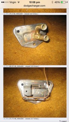

Is this what I'm looking for:
Wow these clearly aren't easy to find. Anyone have any leads besides eBay? I've emailed vintage auto parts about it. They seam to have them shown but who knows if they have stock.
Malicious,
That is the part you are looking for if your car is pre 69. The 69 looks similar but has a vacuum chamber mounted on the engine side of the valve. You can get rebuild kits for them as they leak on the inside of the firewall when they go bad. If you need yours rebuilt, there is a guy in California that restores them. His name is Jim Tucker. Phone: 760 749 3488.

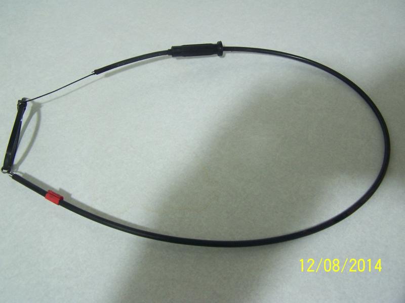

I have a couple of the cables but they are from a 68 Charger with A/C. Not sure if 67 used the same or not. I don't have a 67 parts book. The cable I have is PN 2809-041. It measures 32.5" in length and has the adjuster. Here is a pic $14.00 including the ride
From what I've read, the system is basically the same in the pre 68 setup except the cable pulls/pushes in the opposite way. Ie heat pulls the cable instead of pushes if that makes sense.
