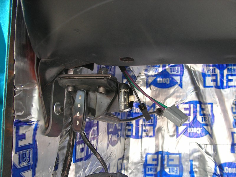

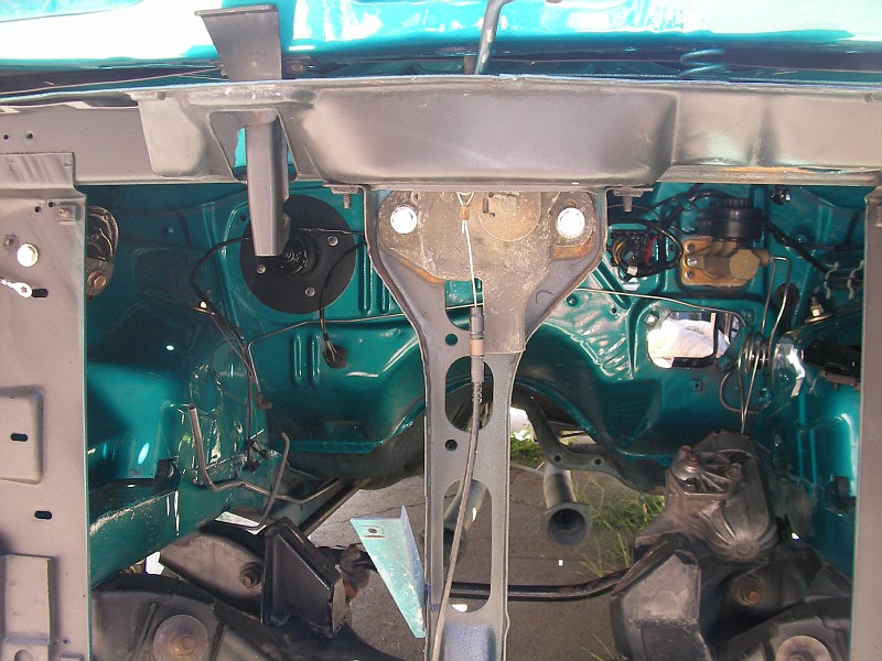

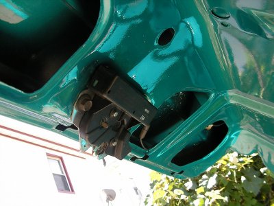

Pics from 2nd forum post
I just installed a `74 Duster inside hood release on my `68 Barracuda. And while I was at it, I installed a power trunk release from a Dodge Diplomat.

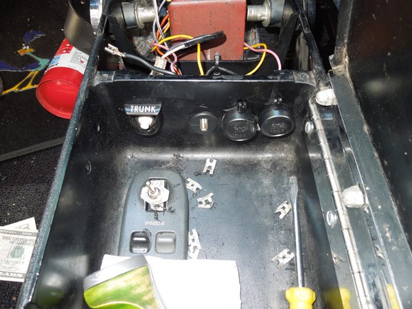

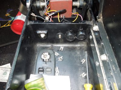

me too i put them in most of my cars and they are easy to find
along with my usb I-pod jack and duel power out let plugs , power window switches and fan on/off toggle switch . All in the console
