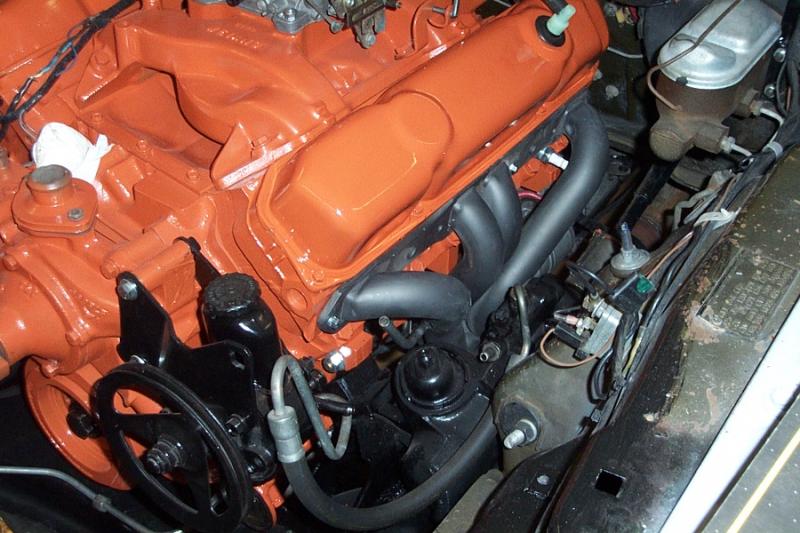

Yes protection is a must. On my driver I used a 30 fuse holder instead of a fuse link. Comes off of the battery post on the starter relay for the main harness feed. Be sure to get one rated for 30 amps and has a 10 gauge wire.
X2...... I did the same on my Charger, I just like the fuse idea better than the links.
