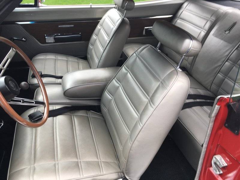

Head rests in my current GTX are restored originals done by the Krusin Moons shop, in Johnstown, PA, when car was owned by one of the partners. Still perfect 20 years later. I repainted the originals on GTX number five, shown below, and installed reproduction chrome trim strips.
Mine are restored original done by the Krusin Moons shop, now out of business. Still perfect 20 years later. I repainted the originals on GTX number five, and installed reproduction chrome trim strips.
