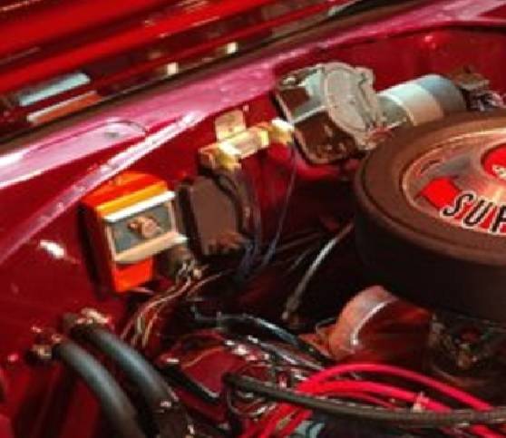

Not claiming any originality of course, but I've always done mine like this:
The ballast, regulator (swapped for an electronic one) and the
orange box fits nice right up under the body seam there.
Makes wiring a cinch too.

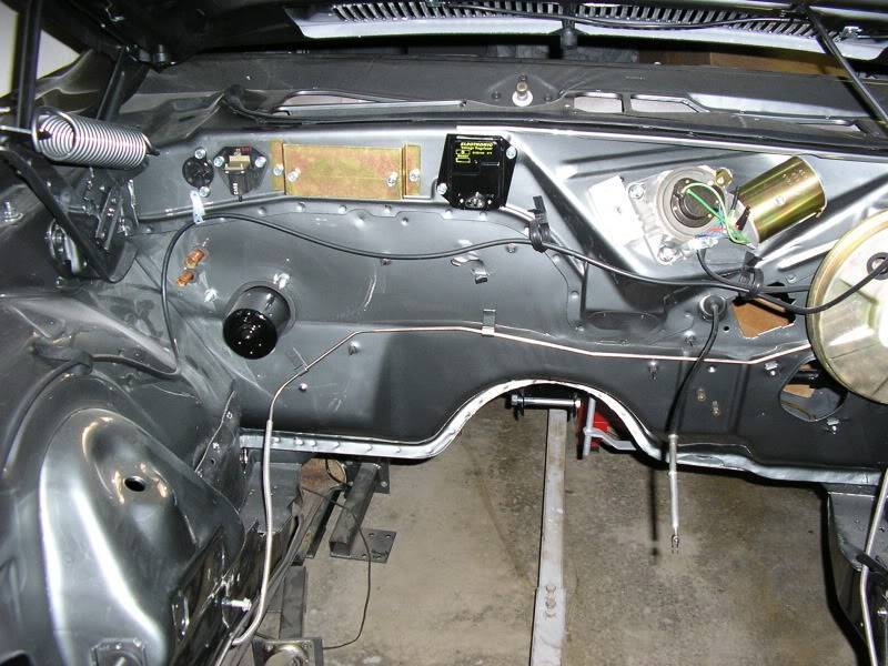

Again, since this isn't stock, there is no right or wrong way. This is how I did it on my own car:
The firewalls on original A/C equipped '70 B body cars is cluttered looking. I added aftermarket A/C which came with block off plates to cover holes no longer needed. I did THIS on a friends car....
