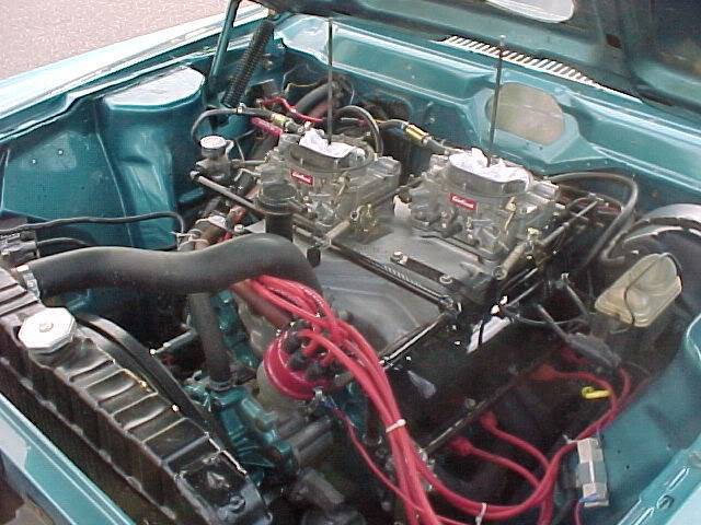

i don't use dual springs for single carb stuff. i use factory stuff and am satisfied with feel and safety. i have 3 springs on my dual quads but that's one for each carb and one for kickdown linkage. i really believe the spring breaking thing could be stretching a short spring too far and fatiguing the metal and aftermarket stuff more likely than not is not as good as OEM. there also is a throttle shaft wear factor on higher spring pressures. some of all this could be personal choice and some sanctioning rules. i'd suggest trying several combinations to get a good comfort level with the throttle.

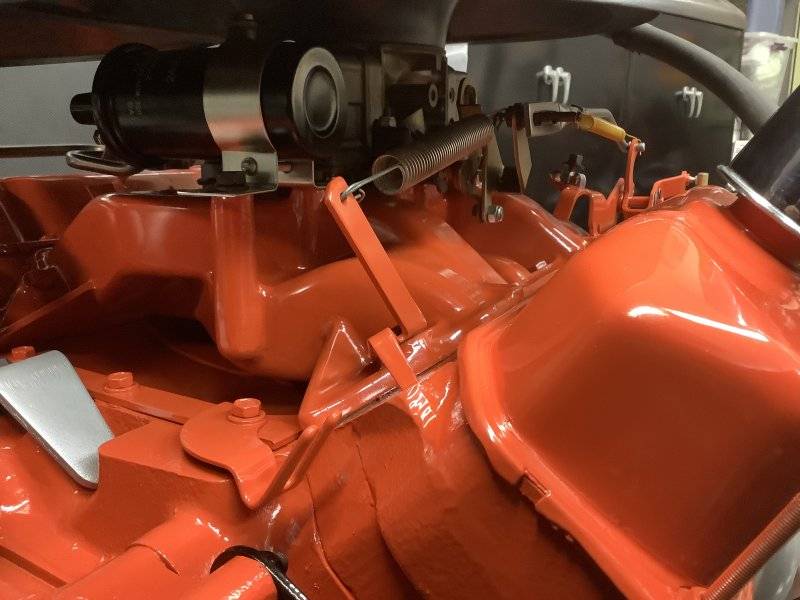

Could one of you post a picture of your spring inside a spring please? I have never seen one and it sounds like a good idea. Thanks.
