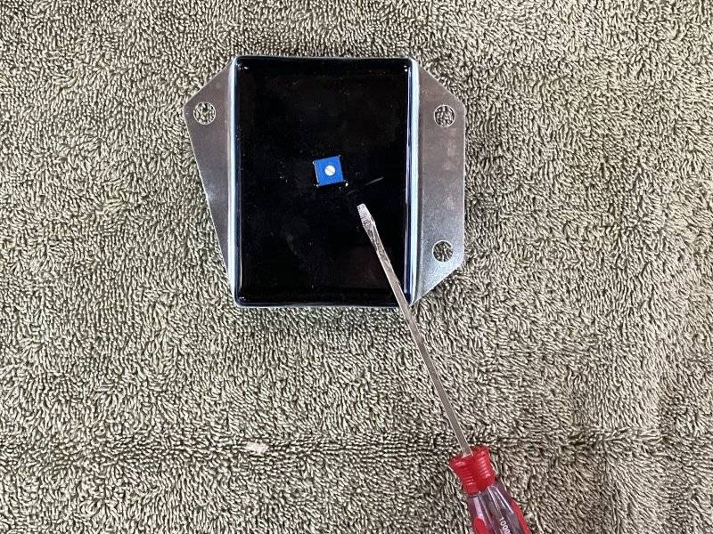

Any of you that have use the adjustable electronic voltage regulator, Have you had an issues with them ?...My regulator is charing around 15.0 volts, higher than I would like.. I've seen in FSM it may charge above 15.0 in colder temperatures (below 80*)..But I have never seen that , maybe you have.

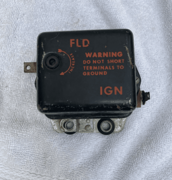

I have a 66 and a 67 with electronic regulator charging as high as 15.4 volts as do a couple other electronic ones I’ve purchased. I had to go back to mechanical regulators to get back down into the 13.8 -14.2 range. Mechanic regulators at least can be adjusted although it’s kind of a pain. No one here knew of a source for an electronic regulator for my car’s era that put out 13.8 volts +/-.
Grounds and wiring resistance are going to affect mechanical and electronic regulators. If your car worked fine with a mechanical regulator, then it will work fine with an electronic one. If not it’s the regulator’s calibration.

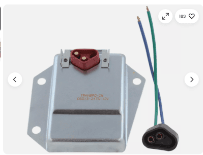

The Transpo adjustable regulator has been working good for me with the 136Amp Denso alternator.
