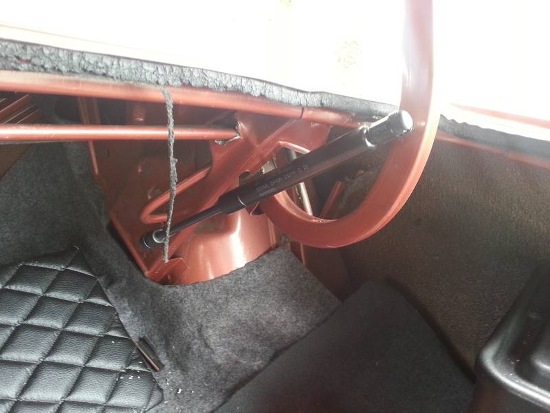

But I’m thinking of doing gas struts on my trunk lid, just like I did on the hood hinges.
