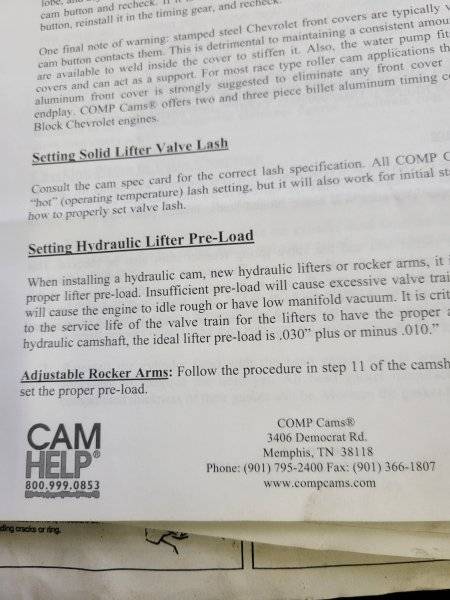

Not all lifters are the same, in fact can be drastically different. So here is a comp instruction( and again, this doesn't take into account the different ones just from this company alone..)
With your rocker, 1 full turn is 41 thou.
I would adjust them 1/2 -3/4.
After finding out which lifter you have of course.
Not all lifters are the same, in fact can be drastically different. So here is a comp instruction( and again, this doesn't take into account the different ones just from this company alone..)View attachment 1340168
Absolutely. Depending on the lifter model (Comp's Pro-Magnums come to mind) they may require a very slight amount of preload.
