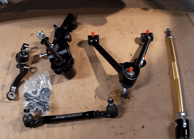

Go with Quality , Stock Replacements —- they were fine for the first 50 - 60 years of these vehicles….
I can supply you with all 17 items in Top Notch Quality for under $ 1000……
