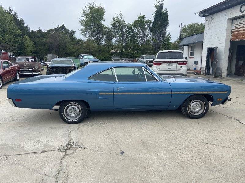

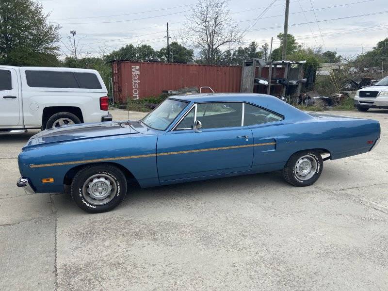

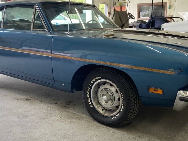

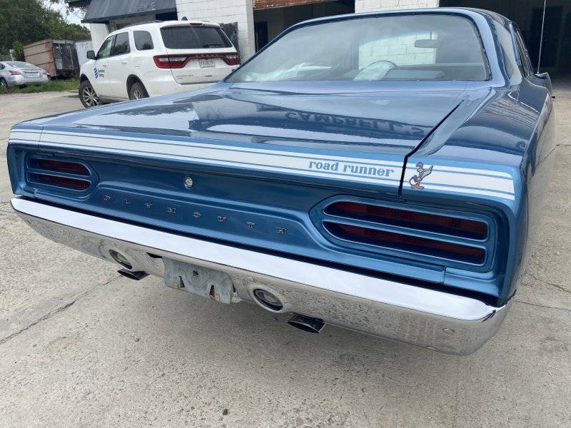

Thanks!!! I got it from another member three years ago and it had most body panels replaced and a engine rebuild around 2012-2014. I took it from there and I've literally done everything else I can think of over the past 3 years. Electrical, all brakes and lines, front end, ECS exhaust, interior, carpet, gauges, dash, cooling, new diff, etc. The only that that is original is the frame, floors, and tranny out of a 67 coronet I think with a 440 done long before me. Other than that it's got its build sheet, original engine, fender tag, and all numbers match. But, it's a brand new friggin car at this point but not so perfect that I won't drive it all over the place. But I would LOVE it if the damn wheel was correct. :) I appreciate everyone's help!!!
