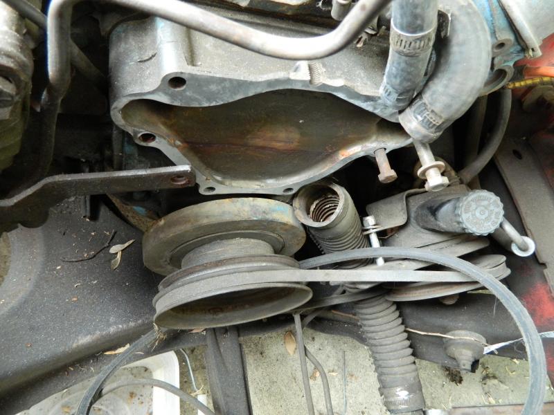

Well busted my own bubble, I have a 72 charger 318, so it is not a poly because it is not in the right yr, but maybe engine was changed out. I am haveing a hell of a time to find a water pump and must come off the drivers side because the fuel pump is on other side and might be in the way. Here is a pic and if anyone can get this figured out, I will buy them a beer. Thanks
Well found one, it had to be 69 318 van, hmmmmmmmm
