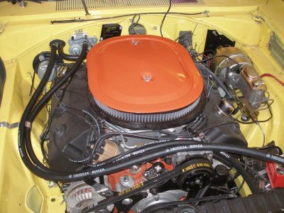

I bought mine from "BPE" Bouchillion's
I put a AC set-up on my 70 Hemi Superbee
See pics:

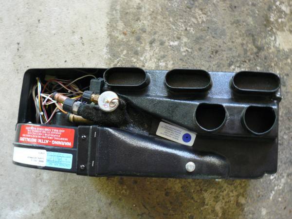

I was going to go "a simple route" in my Dart which was not AC originally therefore difficult to install "factory." I was PLANNING on buying an underhood compressor package, make what I needed, and buy a "knee knocker" evap unit of efray
Then I ran into a nearly complete "this"
It's a universal Vintage air this is a complete heater / AC package
ADVANTAGE: Small and compact, actually smaller than the original Dart unit. This means easier to mount, and no motor intruding into the engine bay. It's heat / defrost / AC all in one, and it's NEW.
Small, light, Sanden compressor, and R134A "ready."
DISadvantage:
No outside vent into the heater box. This means in cool / cold wx (which we have) you cannot run outside air into the heater
The control panel is not factory. Now I didn't HAVE a factory controls setup, but it doesn't "look" "67 Dartish"
WHY did I end up with this? Because I had bought a complete underhood Sanden setup from someone else, and the Vintage stuff came along on CL. I got all of it for less than 1/2 new price. The Vintage stuff was only 400 bucks, and is only missing a couple of hose ends and the hose
"All the stuff" I bought..........the complete underhood Sanden stuff + this Vintage kit, was 600 for the whole deal at the door.
In photo below, "cold air" enters blower in open section at far left, from interior
AC outlets are the three big oval outlets
Defrost are the two round outlets
Of course the heat comes out the bottom at your feet.
