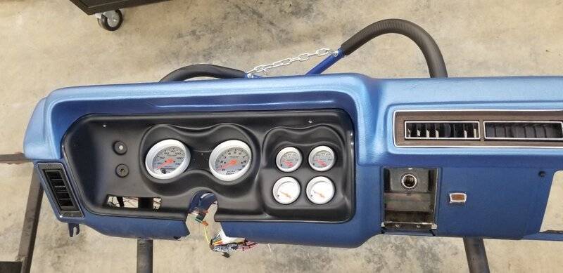

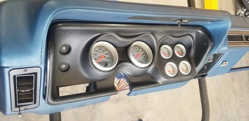

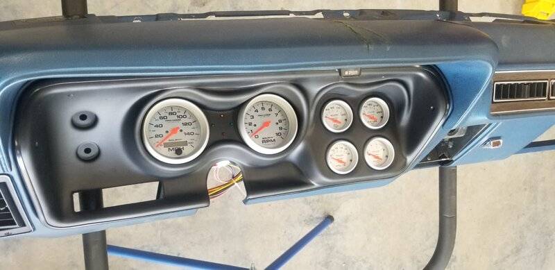

Hi All,
I've seen a few posts of folks asking about the aftermarket gauge clusters. I purchased one from Classic Dash along with Autometer UltraLite gauges. The fit is pretty good and I think it looks great. I'm converting from the old sweep style gauge with idiot lights. It's just mocked up at the moment. I'm waiting on the dash cap before mounting it permanently.
The issues I'm running into are:
1- The wiper and headlight switch bezel nuts won't work with this dash since they are meant for a deep recess. I ordered some aftermarket ones. Once I get them I'll let you know part numbers and how they fit (if they fit).
2 - I have the 3 speed wipers and the switch is super long. Not sure if it will mount ok. I'll see once I get the new bezel nut.
3 - The climate control box had a mount on the back. This dash doesn't have a provision for it but I'm sure I can fab something to make it so the box isn't just hanging from the front.

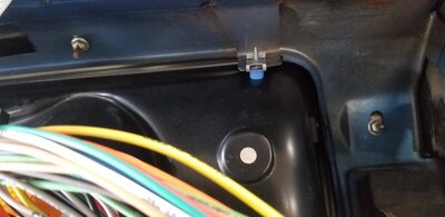

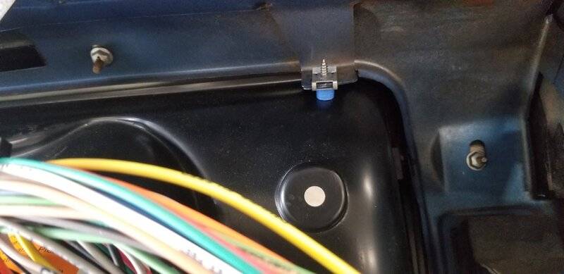

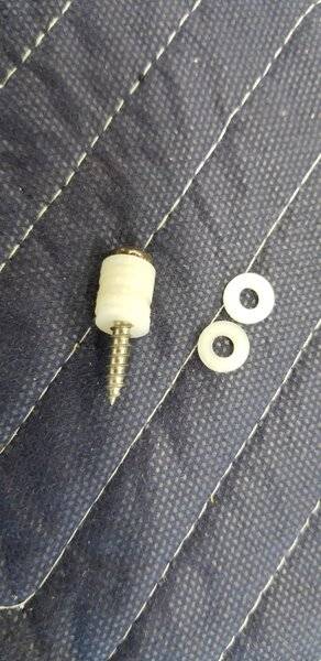

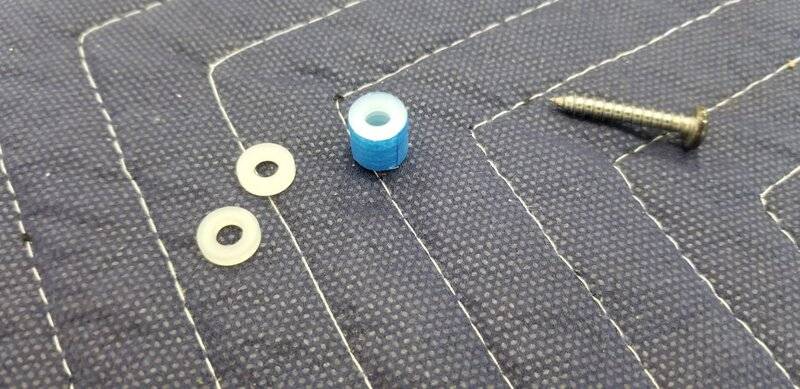

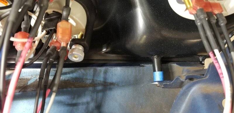

Here's my latest update on fitment. The new insert is a little smaller so the mounting tabs fall a bit short, however, the front fits fine.
What I did was buy some small nylon washers and taped them into spacers and use some longer screws. That seemed to work well.
Next is fitting the climate control.

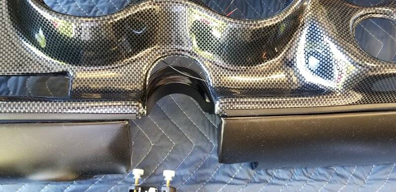

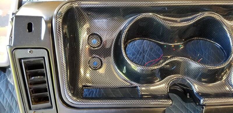

I spent the afternoon trying to make the Classic Dashes cluster I bought fit. I can make the heater-A/C controls fit and get the switches installed with some minor modifications. However, the fit of the bezel is pretty sketchy so I think I am just going to have to eat this expense and just go back to the factory cluster.
I think the best way to fit this bezel is modify a housing enough to keep a partial frame all around. This will allow the propper switches and AC control fitrment
View attachment 1112256 View attachment 1112257
That looks like it fits like crap... No offense to you. I'm glad I checked back here to see how your coming along at this... You'd think for the $ & the tooling, the manufacturer cud make a better product. I'd be very disappointed(& prolly a little PO) if I had to work with that...
My bud had a helluva fiasco with a Classic Dash for his 72 Camaro so I've bn curious to see one of these installed.
I'd call & demand a return...regardless of mods you've already done.
Then put an OE rallye in it & call it a day.

Let me play Devils Advocate here for a minute. All aftermarket parts and even replacement parts fit like crap. That is a given when modifying and repairing an old car. If you can get that dash to fit decent, even if it is not perfect, and I strive for perfect myself, that is sometimes the best you can do. Modifying, trimming, shimming, that is expected to get just about anything aftermarket to fit well and look good. When the dash pad is on and the column is installed how does it look to you?
