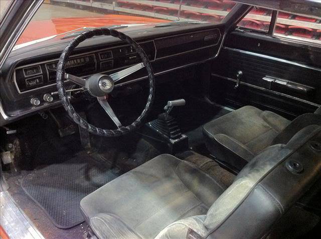

I am trying to get the Coronet I bought in drivable condition, Every single car I got is on hold right now till I get my garage finished but I am trying to either round up parts or at least figure out where to get some parts.
My Coronet is a 66 and when I got it, it came with some hideous buckets seats out of maybe a mid eighties Thunderbird, and a even worse shifter mounted to the floor.
I would like to go with a set of bucket seats that look more period correct, or even aftermarket seats that aren't so ugly. Has anyone tried any other kind of seats that worked out well in a B-body? I am not looking for factory correct, just something that looks close, Any Pictures?
Also what else have y'all (you guys for the Up North People) used for floor shifters? Any other consoles fit this car?

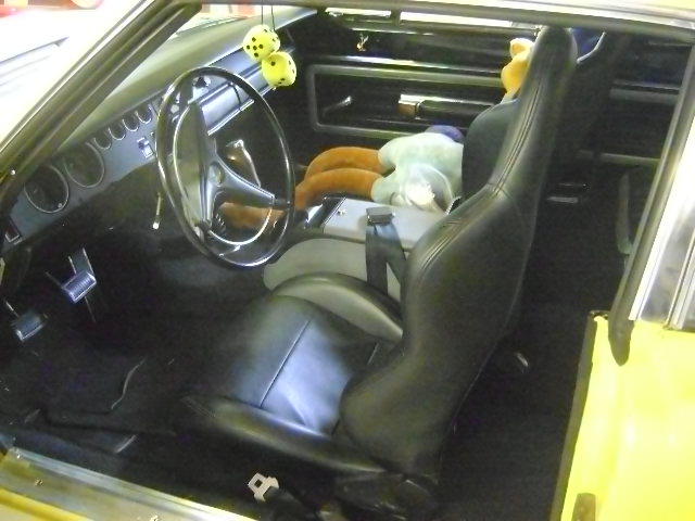

Summit Racing buckets in my 70 Road Runner. They are $150 each plus shipping. I bought a pair for $150 at a swap meet.

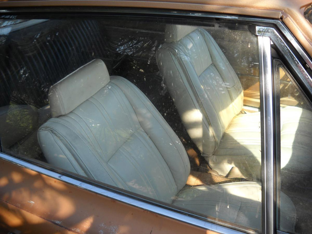

Take a look at mid to late 80's Dodge 600 and 400 buckets.
I got a white leather set from a turbo convertible for $40.
The upholstery pattern is very simmilar to 60s and 70's style, and the back is low with a small adjustable headrest. Not too terribly out of character for my 66.
I did have to pound out the studs and drill one hole in each about 3/4 away from the factory hole.
As a bonus, they recline.
