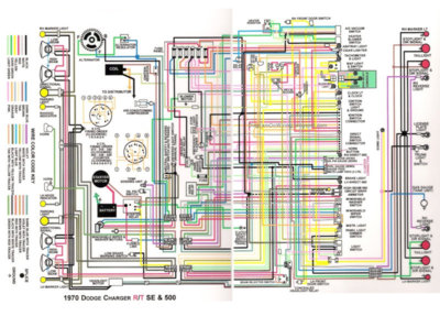

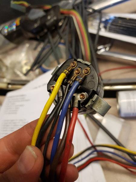

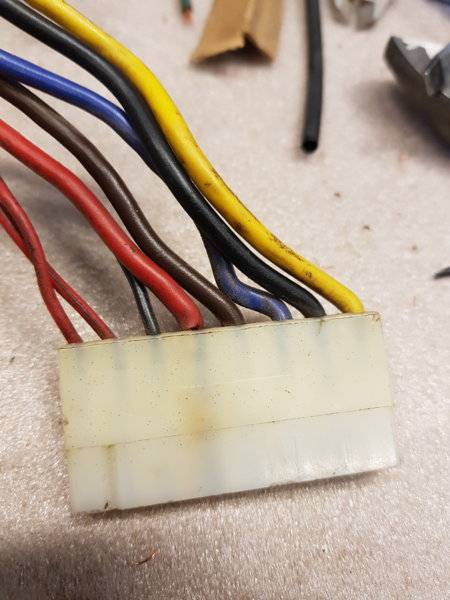

Hi guys! Maybe someone can help me with a question about what cabel goes were.
On a 1970 Charger 500
I have from the new harness
1 Red cabel (+) from battery
1 White that should go to IGN 1 at the ignition switch.
1 Purple is for the out going to starter solenoid.
1 Black/Red that should go to Ignition ACC
1 Brown should go to IGN 2 if the switch has a connector.
I dont know what cabel on the switch is BAT, IGN, starter or ACC.
I hope you can help me.
Complete Wiring Diagram for 1970 Dodge Charger RT SE and 50.jpg 20180525_131027.jpg 20180525_131018.jpg
Wiring diagram is too small to read, even enlarged.
But, suggest, going by your diagram, locate the ignition switch, and the 8 wire straight block, in your pics. Once found, trace each wire to see where they should go, and verify each one.
You'll get it figured out!
