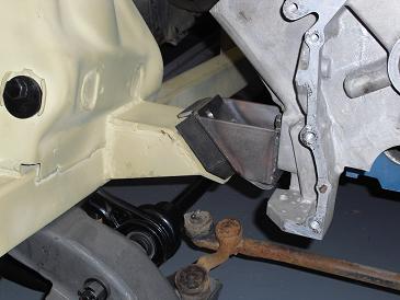

Pics of mount etc...

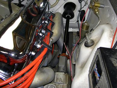

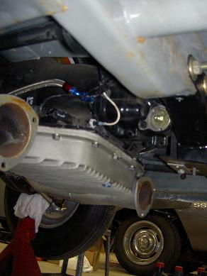

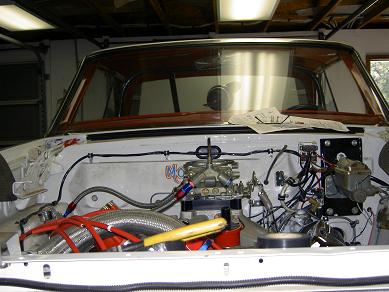

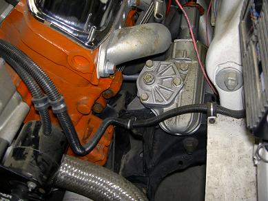

These are the pictures of mine...if you want a picture of the motor plate I will send tomorrow. By using the '70 K-member it did move it back 1.5" but it didn't move it lower. All I did with the tranny mount was turn it around and cut the back end off so the mount would stick out. Look at pics. It didn't move it left or right at all. It just moved it back, not down.

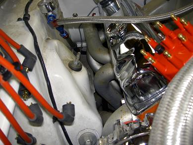

The offset is measured at the crank. The engine actually will look crooked in the engine bay. Look at your Peddler pict, esp. at the injectors popping through. Look at the opening cut lines on the sides, and you'll see its crooked.
I'm just trying to find out what the factory did for an offset.
Mark: got an overall engine bay shot? does the engine look like its pointed crooked?
Engine does NOT look crooked. Will get you an engine bay pic by the end of the week.

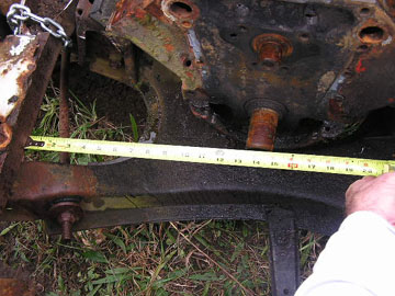

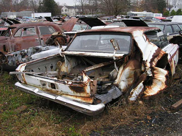

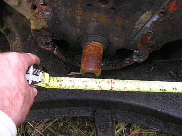

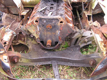

Here is a early B, 63 Sport Fury with a poly 318 block. I cut out the shock towers to have another set "just in case" things go wrong with our first set in moving them.
Notice the offset???
measured bias to be 14" from crank snub to R rail, 17.5" to left rail.
There is a little more twisting than stock, as I cut the rails somewhat to remove the towers...but there IS a signifigant bias.

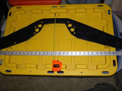

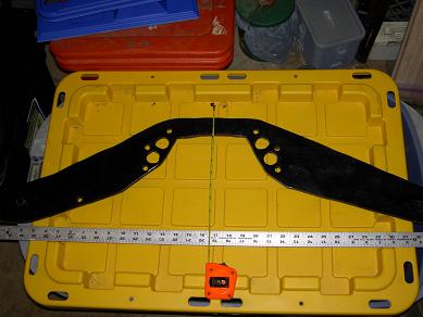

motor plate can trace can trace one for you and send to you if you pm me your address. don't look for anything until after Thursday, getting married this Saturday. Mark

Stay with the original 3inches. How bad was the trunk floor in that mangled '63 Fury? I need a patch for my Polara!

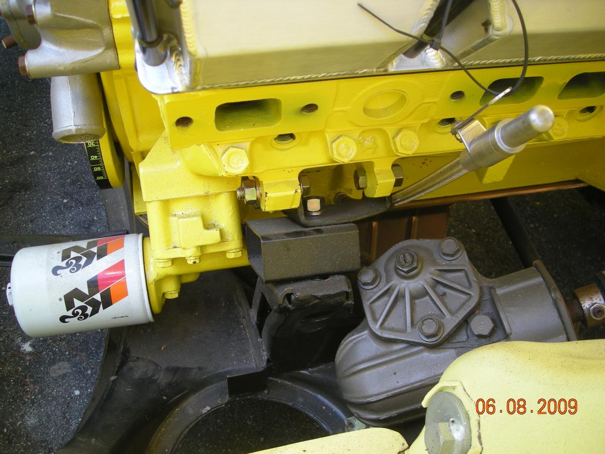

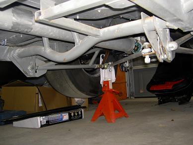

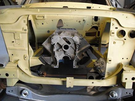

This is my second afx as my first was sold to finance my shop. We used an origional hemi mount for one side and made a fabricated alum block the same size for the other side. We set the motor tranny in and used a level. The rest is cut and weld cut and weld. I like this much better than a motor plate.
howie how did ya bolt the k-member to the new frame rails?
when i did mine i got a peice of thick tubing, drilled a two holes per rail at the rite location, then welded the sleeve into the rail so when u bolt the k down it won't squish the tubing..

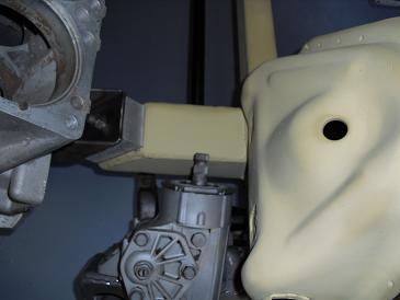

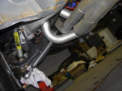

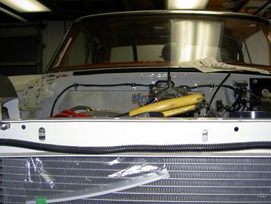

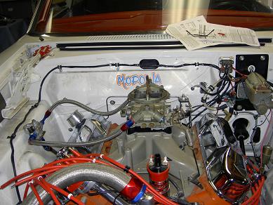

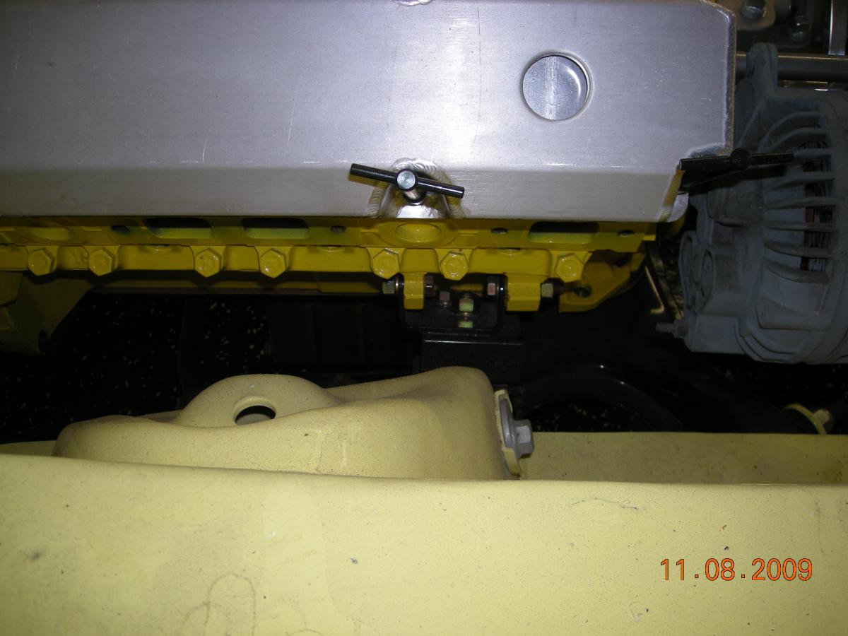

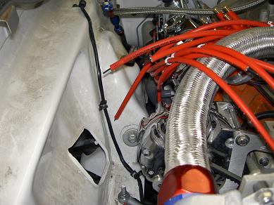

Here are a few pics of my ride.. It sure looks like 3" off to the side. My issue is that the 727 is on the tunnel... What do I need to do to the tranny mount to correct this problem. I also had the notch the K member for the deep sump....
