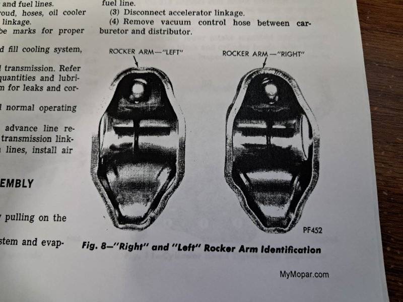

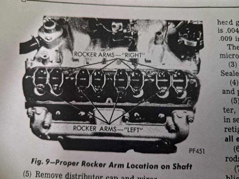

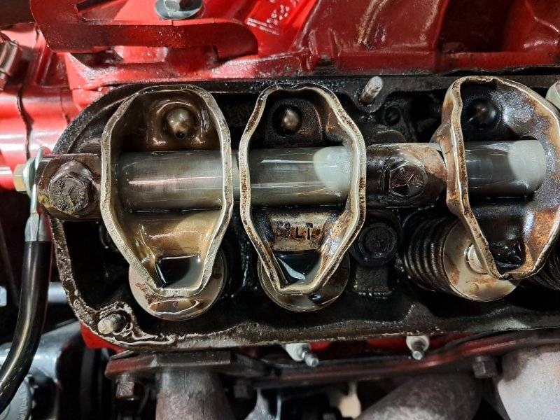

When I removed valve covers, right side rockers are installed correct, but left side are installed with the tips of the rockers offset inside instead of outside.
Talked with previous owner: he never touched rockers. This problem could have been ongoing for 29000 miles (total mileage on engine since build) although the engine has only been in the Coronet for 2000 miles.
I expect the left head's valve seats are damaged.
*Do you think damage to valve seats could cause low idle vacuum?
*Could prolonged use of rockers misaligned on valves crack the left side head?
*Has anyone had this head problem long term? What repairs did you make?

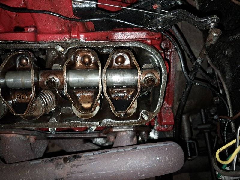

Cylinder 1, rockers marked LT should be installed to left but are installed on right.

Cylinder 3, exhaust rocker looks fairly new and is correct. Intake should be left offset.

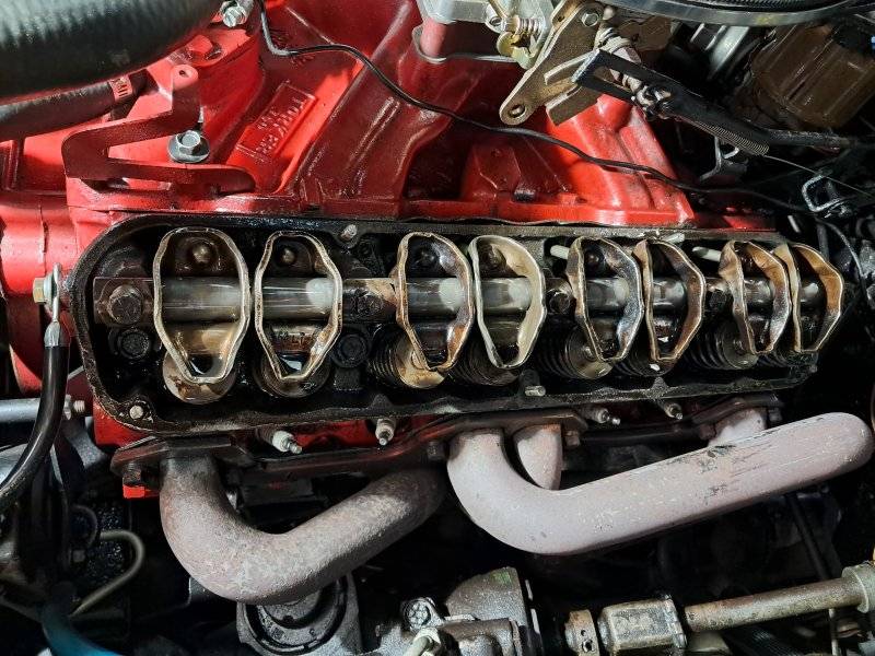

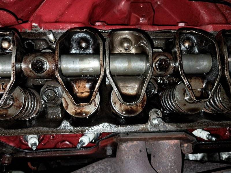

Cylinder 5, both rockers installed wrong
Cylinder 7, both rockers installed wrong

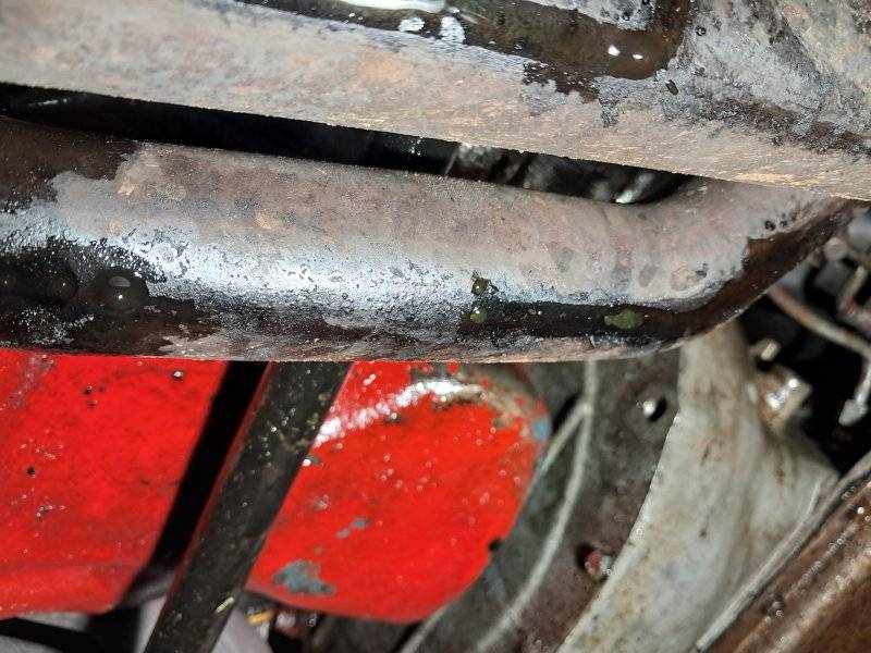

Oil leak on header from valve cover contains coolant, but cold engine withstands coolant pressure test at 15 psi without leak down.

*Cylinder pressure is leaking past the valves on left side and blowing oil out from under and over the valve cover gasket. New steel core valve cover gasket does not help.
*My plan is to pull the heads and check the cylinders. I posted this thread for advice before I start disassembly. Wanted to see if there was something I didn't think of.
The camshaft profile is where your missing vacuum went.
Probably didn't hurt the heads.
Could have worn the guides or valve stems.
Since it's not oil fouling the plugs put the rockers on correctly and run it.

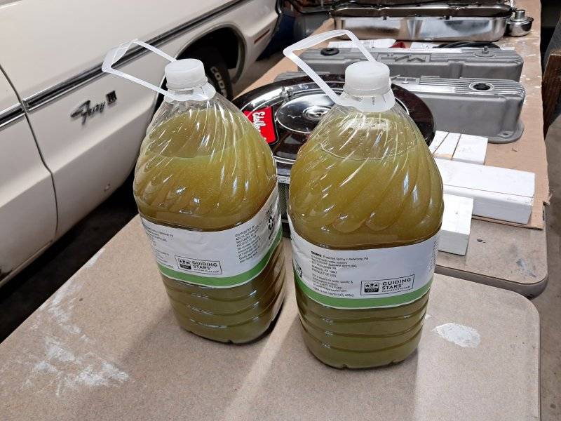

Anyway, I drained the coolant. This is the color after 2000 miles of use and 8 years in the 1966 Coronet
I'm starting to suspect that somebody lied about the rebuild and all that was really done was cam swap. Leaking core plug evidence below. How many times have you seen core plugs leak on a rebuilt 318 or 360? Grrrrrrr! To double the trouble, headers make core plugs impossible to see, much less replace. Love the car!!!!! but the engine may have to go.
